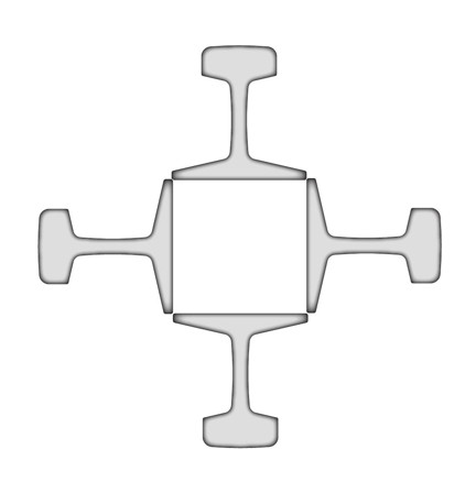

A more common steel that doesn't rust away easily is railroad rail.
Get 3 or 4 pieces of the same size. Weld them together at the base edges for a strong, rigid post.
4-rail post:
Bruce
   / Gate post metal type? #5
That should be a heavy enough "post". An 8' length of 4-rail post would weigh almost 1500 pounds.

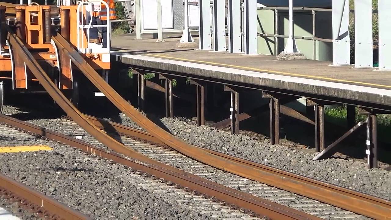

I would think that a single railroad rail would take a lot of weight before it would bend. How heavy is this gate?
   / Gate post metal type? #8
I've seen a 3 railroad track post... certain it will last as long as the pyramids...
   / Gate post metal type? #9
Single rails are surprisingly flexible. That's why I suggested 3 or 4 welded together.
