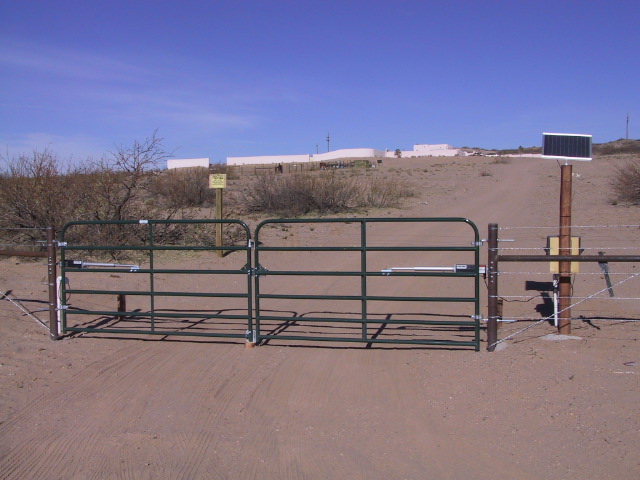

IrTxRx, I purchased a GTO gate opener from Gate Crafters, who are in Florida, on-line. It is supposedly rated for 600# leafs. I have a 16' gate opening with dual live stock gates. The individual gates probably don't weigh more than 60# each, so there is plenty of torque in the openers to move them in the highest winds or to push some tumble weeds out of the way.. I have about 400' to the nearest outlet so I went with the solar powered charger and haven't had any problem. With my system you supposedly can cycle the gates 40x a day with out running out of juice. On their web site they have all the information you may need to make your decision. I am very happy with the product and the dealer support.
Stonefox

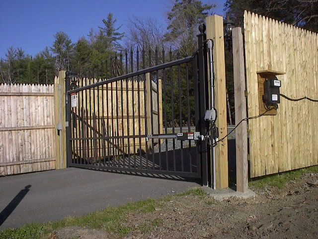

Here's my gate and GTO Pro1000 opener. G

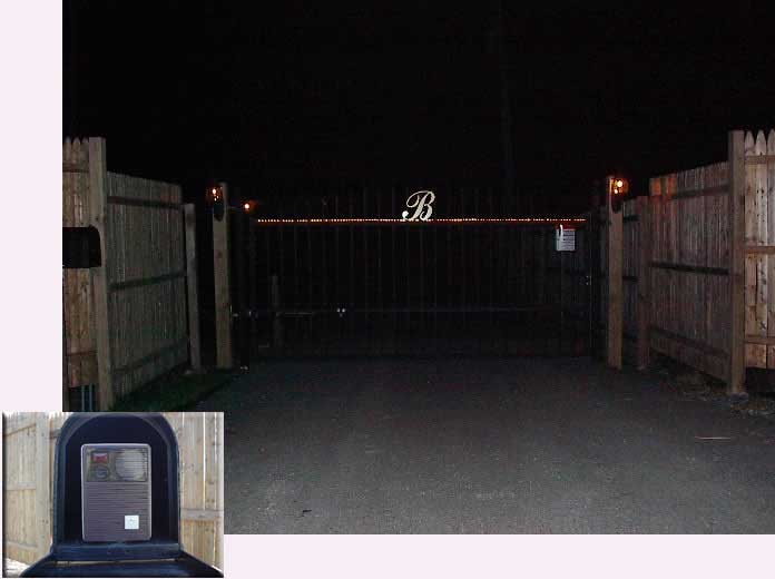

Another View. G

I was going to get the auto detector but instead ran a doorbell button into the house and installed it next to my Video Intercom. That way I can see and talk to who's at the gate and open the gate from the comfort of my living room. I am "wired" direct for this. All vehicles (3) have remotes.
When I leave, I'll open the gate and the garage door from inside the house. I also bought the digital wireless keypad (set by the gate) and several additional remotes for the tractors, snow blower etcetera. G
