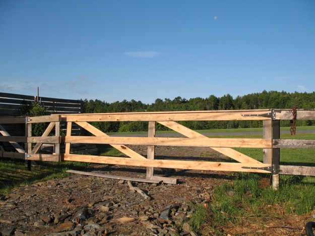

I have 16' wooden gates. (Actually I have a 20' section as well - 16' plus 4' gate). I used 10" hinges and welded 1.5"x20"x1/4" flat bar to the hinge. I ground the end to a point - fake forged end. I leg bolted hinge to posts(oak) and to the gate. In the middle (8') of the gate I made a support leg with a small pneumatic wheel. The leg/wheel supports the gate as it is moved.
The gate is three rails plus top cap rail to match the fence design. The gate and fence is made of 1x6 hemlock painted black.
Attached is a pick during construction stage minus leg/wheel, paint and final fitting.

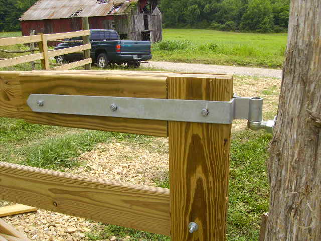

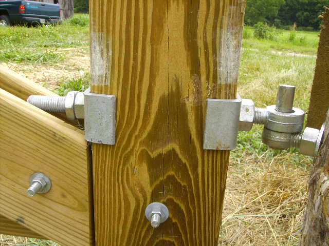

I bought some gate hinges on ebay. They are very heavy duty and come in three sizes for gates up to 8' wide. The neat thing is they supply plans for building a very attractive gate to be used with their hinges. I also needed almost 16' of coverage width so I built a pair of gates and hung them with the hinges. The gates are heavy but the hinges are very heavy duty and do a great job. As long as your gate posts are well braced you will get no sag with these hinges. Search strap gate hinge on ebay or private message me and I will give you the link.

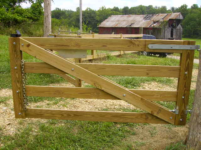

We've made quite a few gates for our community project, using regular pressure treated 2"X4" stud rail and some 9"X2" for the large upright on the side of the post. We wanted to make them a little fancy so we cut a curve into the top of the large upright where the diagonal brace is connected, to give a little bit of style. You will need to make half lap joints on the ends of the diagonal brace, but not a complicated task by any means. Use a good quality adhesive on all the joints and bolt together with coach bolts....
It is amazing just how cheap it is to make these gates.
For a pair of 8ft gates, the 4"X2" would be fine. A gate longer than say 8-10 ft would get a bit squirrely when you swing it. You'd have to consider beefing up the materials.
