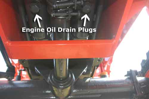

My tractor has two oil drain plugs, a few inches apart. Without taking the oil pan off to satisfy my curiosity (or you'rs for that matter), there is no reason for two drain plugs in basically the same location...unless there is a baffle between the two halves of the pan. Many cars have "dual sumps", dual oil pick-up points and more than one oil drain plug...such as in foxbody Mustangs. Tractors are designed to work on slopes and weird angles at low rpm's, without provisions for such conditions oil starvation could occur. Either more oil is needed or baffles would solve the problem. Too much oil creates different problems, so a baffle or baffles are the best cheap solution. A thin piece of metal welded to the inside of a pan ain't rocket science...imagine that. Have I taken my pan off to look...no. Would all tractors have baffles, probably not.

Look at Kubota for instance. Here is one picture I found with dual sumps due to the AWD driveshaft. "Some" would be the "righter" answer vs. "many".:)
