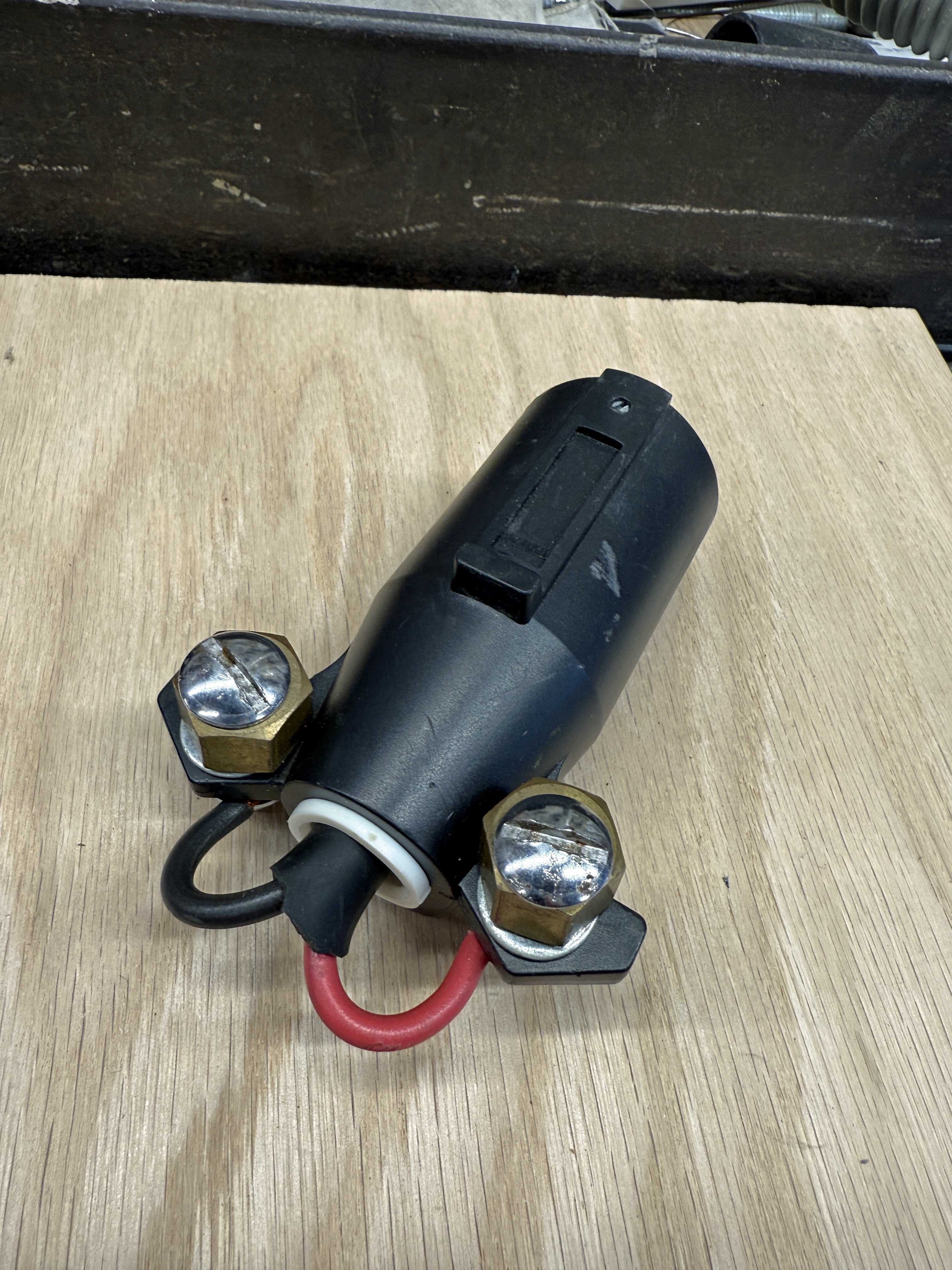

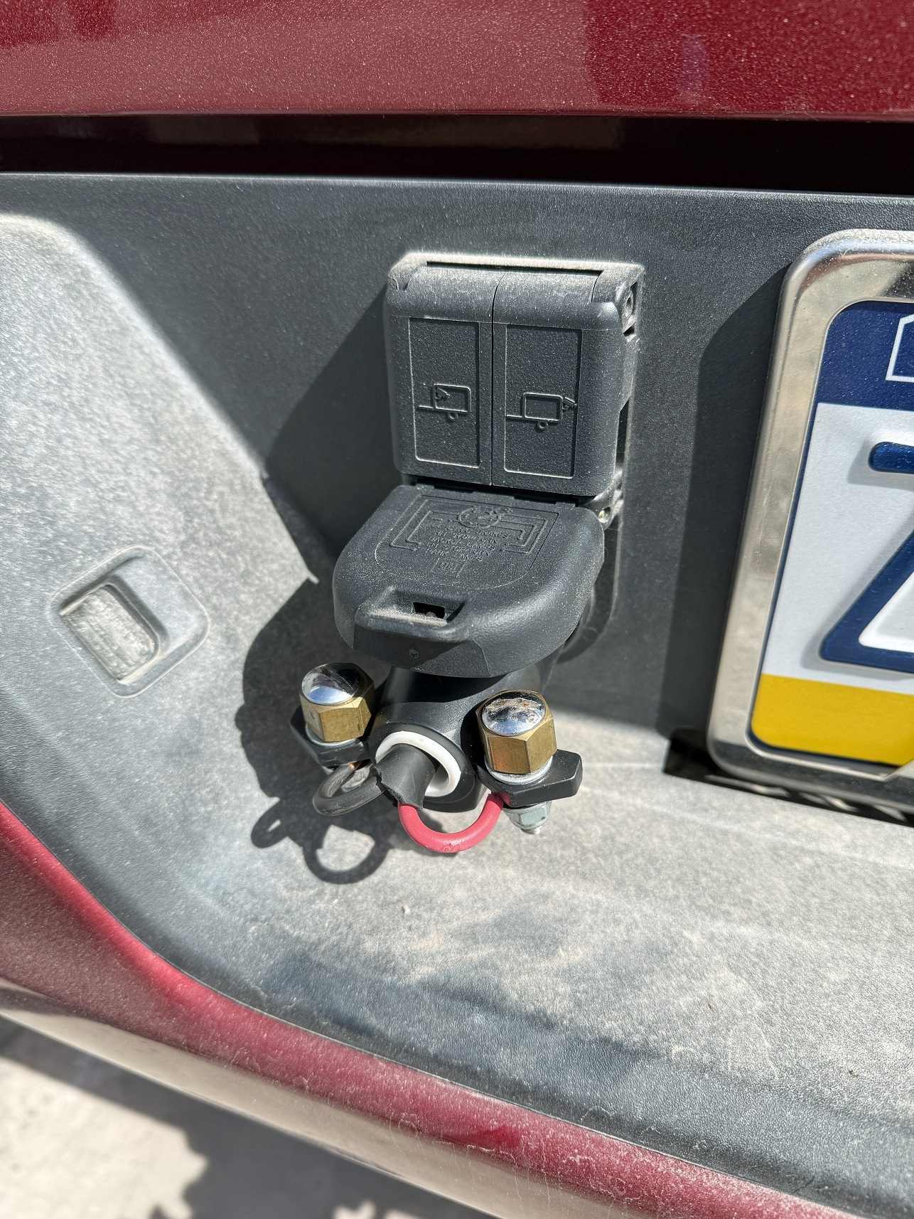

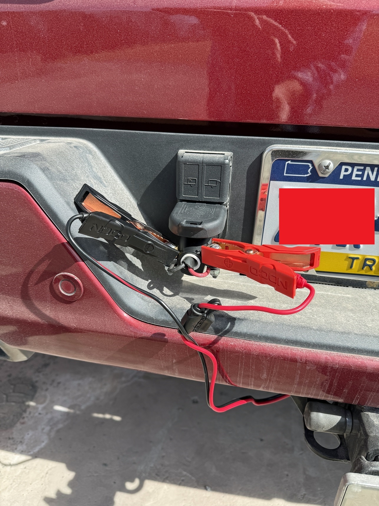

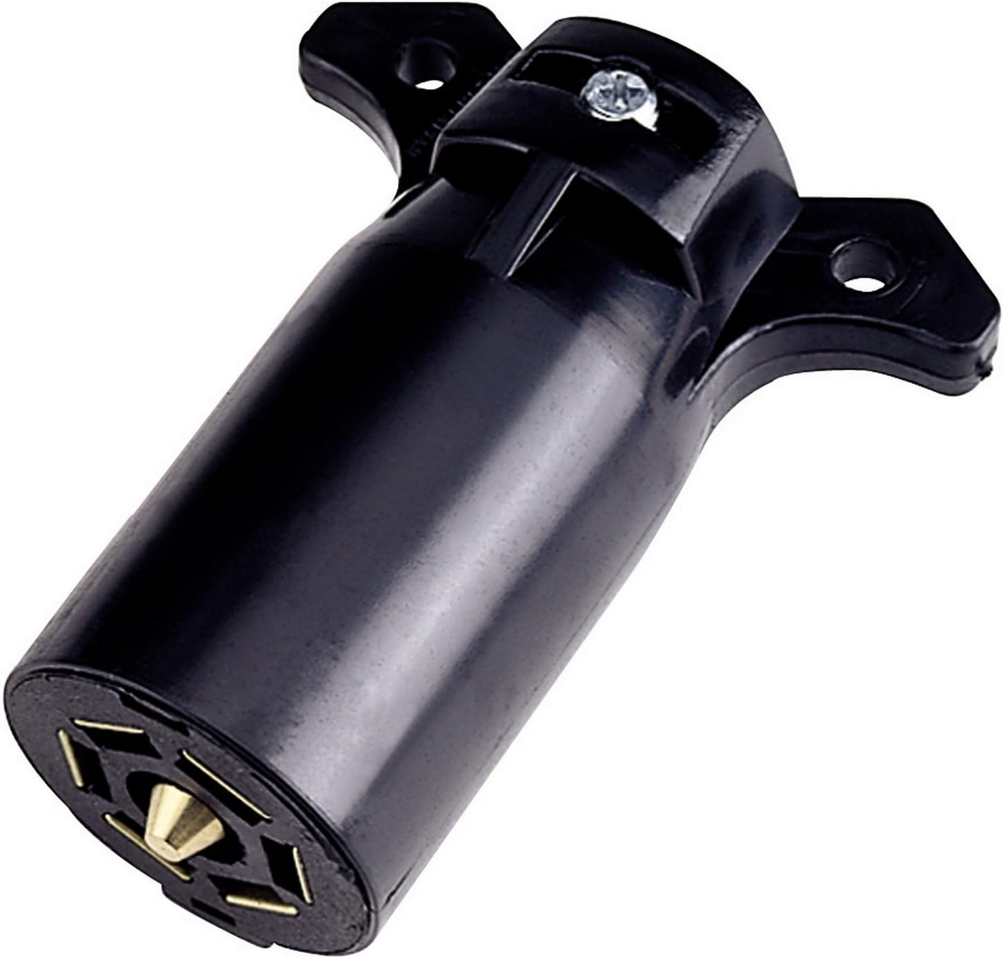

Are those spec'd for gas? I've only seen diesel. I use a trailer plug on my diesel pump and plug into the trailer plug on the bumper (has 6-pin with 12v aux). No need to open the hood and attach to the battery.
The aux circuit on my pickup is fused at 40 amps. I modified this 6-pin trailer connector so the circuit can be used with alligator clips. I use it with a compressor, pump and even a small winch
