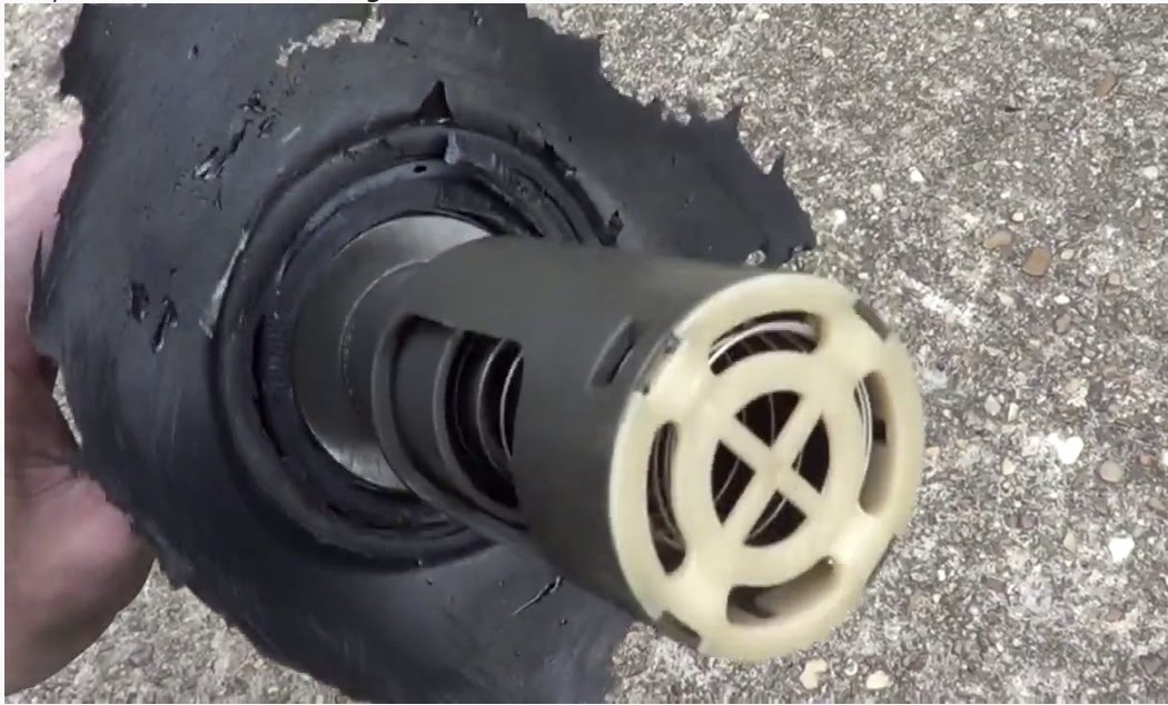

First off, can you get a hose down the filler neck of your truck and back out?
^This! Unless you have a really old truck all the newer ones won't allow a hose down into the gas tank. That's why these days gas thieves drill the tank itself - no way to siphon out of the tank.
Don't know what all the other manufacturers use....but this is what the fill spout in a newer Ford F150 looks like. Made specifically to NOT allow a hose into the tank:

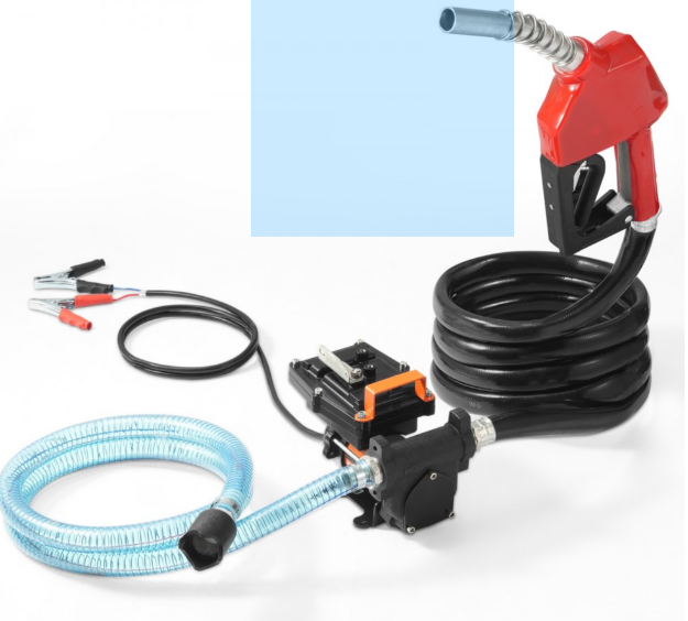

Sure, at least a 1/2" hose will fit. This is not to fill the mower in the yard but to refill the cans at home to avoid the hassle of hauling them back and forth. I found this but it require power to a battery, trying to avoid having to hook up to the vehicle every time!

Sure, at least a 1/2" hose will fit. This is not to fill the mower in the yard but to refill the cans at home to avoid the hassle of hauling them back and forth. I found this but it require power to a battery, trying to avoid having to hook up to the vehicle every time!View attachment 2942547
Are those spec'd for gas? I've only seen diesel. I use a trailer plug on my diesel pump and plug into the trailer plug on the bumper (has 6-pin with 12v aux). No need to open the hood and attach to the battery.

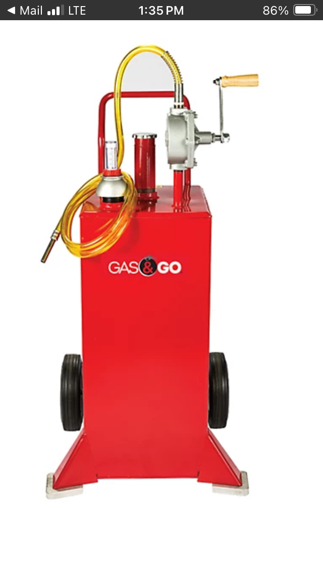

I’ve got 2 30 gallon gas caddies. They are expensive but I got mine bothe used for under $200 apiece. You wold never regret it.
