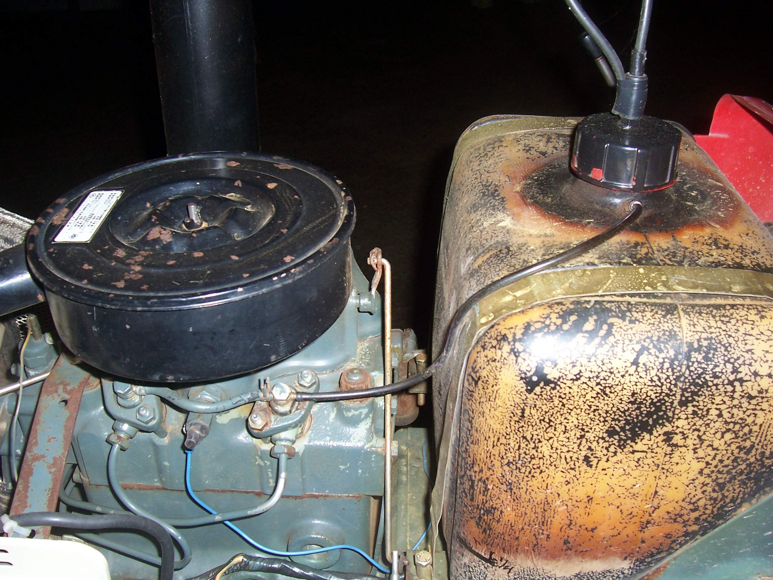

I don't have strainer on my Tank either and if I did I wouldn't of had to vent my Tank with a notch on the Strainer. Normal on alot of equipment. My Diesel can has Screen. And my Funnel I use is Screened also. Thats how I keep the dirt out. I had a Old vent tube setup I used from a old ATV. Gas cap. A Mid 80's Bayou I bought for parts that workes like a champ ;) I actually seen the Air Bubbles coming from around the Injector return to the Tank leaving a puddle on top of the Tank. I just never had a good feeling about letting it go leaking Fuel Right in front and just above the Fuse Pane.:confused: After taking care of that I knew there would be a very good chance of the Tank getting pressured up blowing a Seal. Seen Fuel coming from around the Fuel cut off at the Filter also come to think about it. That's why I put a 10min. Ghetto Rigged on the cap and cured that problem.;)
