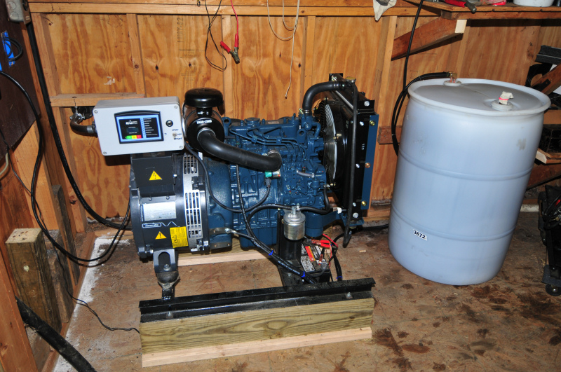

check these guys out the 9kw looks good
Kubota 9,875 Watt Diesel Generator

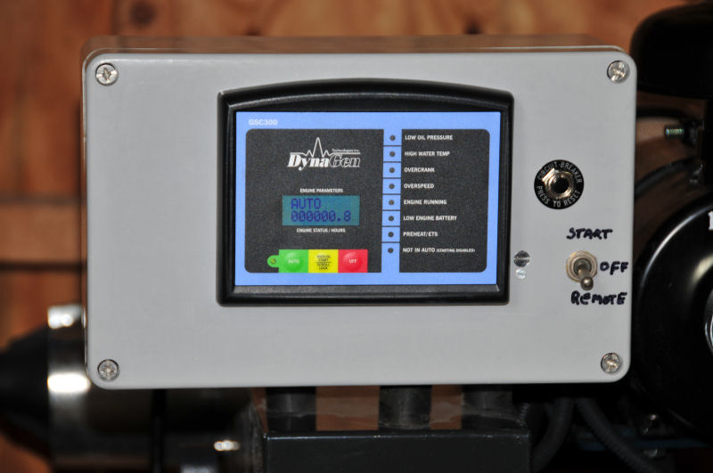

I have this unit. I can testify that it is a solid, well built unit, well worth the money. I got mine about 2 years ago, and it has powered us through Irene, Sandy and a few other minor outages. It has a good overload (surge) capacity and enables me to have my 3 heat pumps running. Consumption in my case has been about 0.5 gal/hr. I would advise having them add the start controller if you buy one. It was under $ 200 and adds all of the safety cutoffs (temp, oil, voltage, etc), id does the glow control, cool down, and displays frequency, total hours, battery voltage, etc.
I would give this genset high marks.
paul
