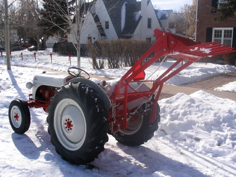

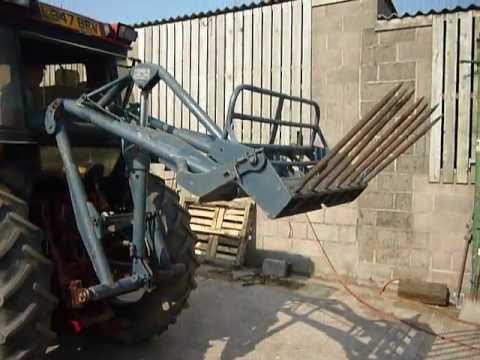

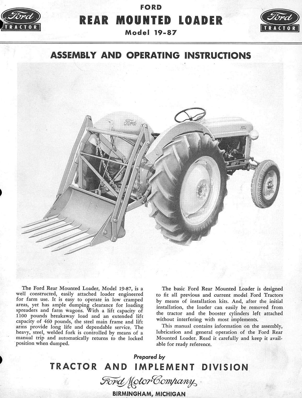

in years past when loaders were first being added to tractors, many were mounted on the old tractors backwards, putting the weight on the rear tires,
and some also worked more like a fork lift so the bucket and arms are not in the way of the operator, picture in link
http://www.ntractorclub.com/eds_stuff/ford%20tractors/Implements/Loaders/Model%2019-87%20Rear%20Mounted%20Loader/Assembly%20&%20Operating%20Instructions/Front%20Cover.jpg
build a sub frame that goes under the tractor, and build the loader on the sub frame one hydraulic lift cylinder and possibly a tilt cylinder or a trip dump,
