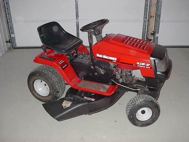

I mow roughly 3 acres and this is what I use. It has a 16.5 HP B & S with hydrostatic transmission. They are now under a thousand dollars. Mine has been going strong for 5 years now.
