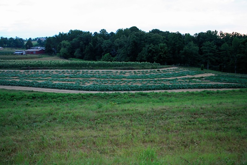

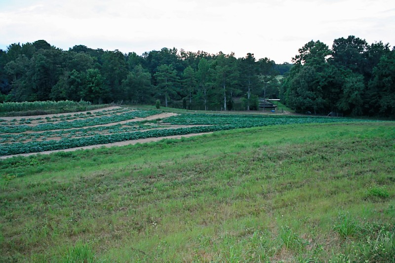

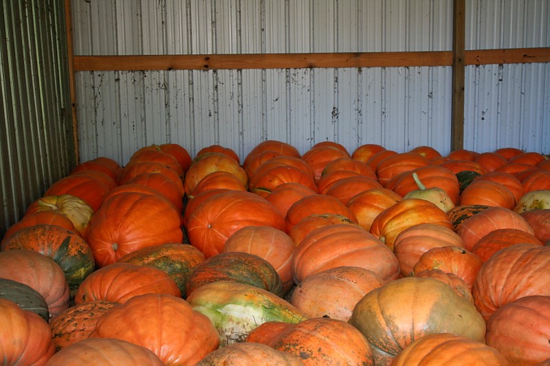

I watered 3 acres of pumpkins last year with a 2" Pacer Pump Pacer Pumps - Gas Driven S Series Pumps - EconoAg (200 gpm). I used T tape T-Tape (Drip Tape) - Dripworks Drip Tape For Row Crops drip irrigation tape. A total of 12,000 feet of tape. This tape was buried beside the row. I made a plow for my Farmall to plow it in about 6" deep.
I could water the entire field at one time with this 2" pump. I would crank the pump and let it run until all the lines were pressurized. I bought fittings to go on the end lines that were cut off valves. I would go to the end of each row and open the valve until clear water ran out. I then would turn the pump down until I had about 15-20 psi of pressure on the lines. I could water over 2 hours on a tank of gas (about 1 gallon)
I did not run a filter on the line and had no problems. About once a week I would run Clorox through the lines to kill any bacteria or algae.
On Edit: I can post pics of how I set up my pump with a pressure guage and induction line, so you can use liquid fertilizer and pump it directly into the lines with the water if you want.
I plan to buy another of these pumps for this year. One to use at my grandads to pump water onto a patch of pumpkins and another to use at my house to water another field of pumpkins.
Chris
