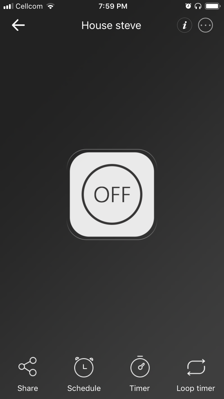

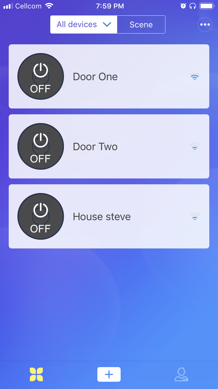

that is the EweLink app on my smart phone. Has all my garages on it. It ROCKS, in the loader have an opener, on the lawn tractor have an opener. Need to pull some one else's car in, you have an opener!
I had the silly flo light interference issue, cutting down the opener range, problem gone. In fact we now have the opposite issue, because you can open it from ANY where.
I was also tired of the batteries running out on the opener I did have.
Best of all its cheap to do! $20 a door. When you have to replace those stupid openers they cost more than that.
You do have to have wifi in your shop and garage and well you need a smart phone.
You hit the app on your phone the above pops up then you select the opener you want.
the below opens
Then you hit off. phone vibrates garage opens. Hit it again it, closes.
You need to wire one of these a crossed the switch contacts
https://www.amazon.com/EACHEN-Monen...073498&sr=1-1-spons&keywords=wifi+relay&psc=1
Then I ordered the 12v adapter from here.
12V 1A AC-DC Power Adapter RC SPS-121 | MPJA.COM
The EWElink app walks you through how to get them on your network, phone ect. It is pretty self explanatory.
Once you get used to slapping the phone on the holder on the dash once you get in the car, use it is pretty easy.
Wife even likes it.
There is one issue, if you have one module and want to share it, you end up having to log in and out it can be a pain. So, for the house i put two in parallel. Wife has one I have one. Then no need to log in and out. When employees want to pull vehicles into the shop, THEY HAVE AN OPENER.

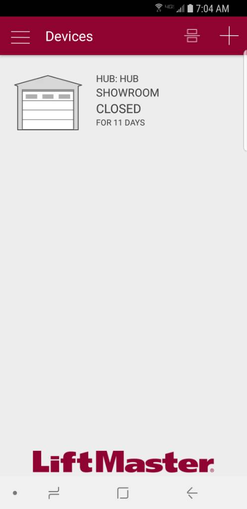

The low price is great, but does it have a feed back to phone to let you know what it's doing?Screenshot_20190202-070405_LiftMaster.jpeg

The low price is great, but does it have a feed back to phone to let you know what it's doing?View attachment 589841
No it does not. I was skeptical at first so I only bought one for the garage that we were having the flo light ballast interference with the remote range issue. As long as your careful..... i mean you can hit the regular one when it is in your pocket and open the door and if your not watching the door close, the dog or cat running through can open it again. There is not any feed back on the old style opener... The phone app solved a lot of issues for us as the old style opener was not cutting the mustard.
