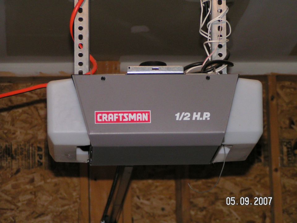

My house is only 3 years old. I installed two Sears garage door openers when we first moved in. One works great, the other really aggrivates me!!:mad: For the first year, it worked fine then all of a sudden did not. It started to travel too far which would cause it to hit the floor tripping the sensor which would make it go back up.
I thought maybe it need to be adjusted a little bit. Needless to say, this has not proved succesful. These days, it either stops one inch from the conrete, or goes to far and bounces back up.:( :confused: :mad:
The wife says to get a new opener, however I don't feel like spending $150 if the fix is not that hard.
Any suggestions???:confused:

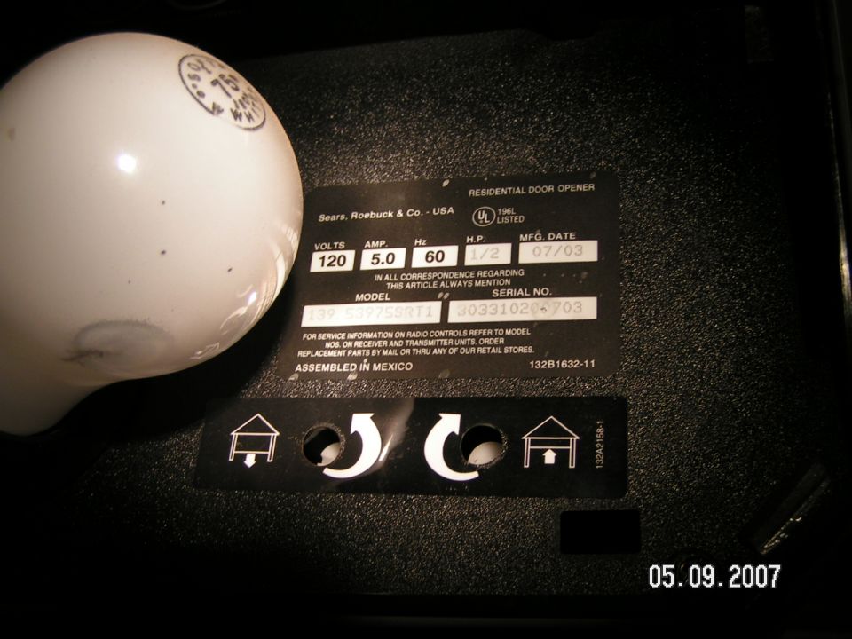

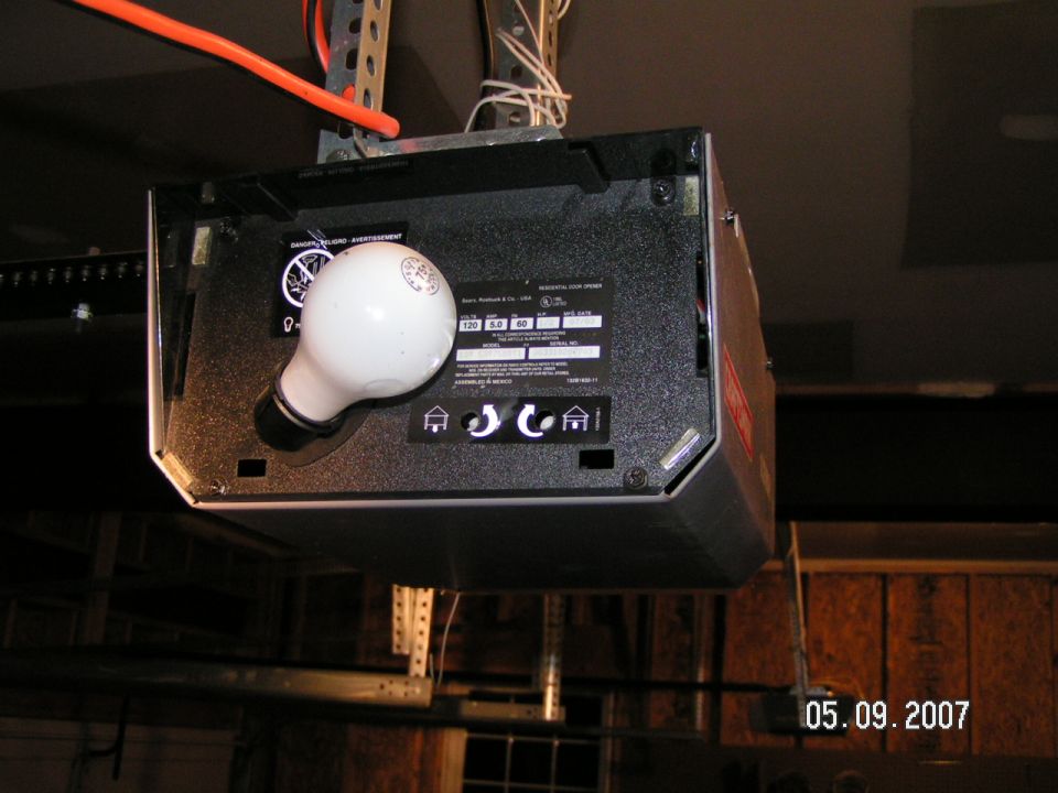

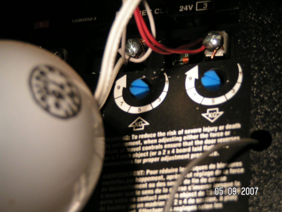

Sorry for the delay guys. It is budget time and I have been working non stop. The model number I got off the unit is 139 53975SRT1. I also attached a few pictures of it. You can see the height and pressure adjustments as well as the unit itself.
This unit worked great for the first year or so. Then it just started getting tempermental. I have also checked the beams. The door will not start to shut if the beams are not aligned right (have had this happens as well).
I sure would appreciate the help. I don't know the first thing about sensors. However I am a fast study.:)

OK, if you type that part number into the parts search at the sears website Welcome to the Parts Store you will get the exploded views and installation diagrams. This is one of the things I like about Sears as if you have the number, you can find most of the diagrams and documentation on line. Here is a link to the print I found most valuable.
Imaging Page
In the last pics you posted, you can see the open and close stop point adjustment screws. Your switches are actuated by a screw driven contactor behind where those screws are located. If you remove the bottom cover(4 screws) you should see the limit switch mechanism driven off a worm gear on the end of the motor. There should be a grey wire that goes to the center contactor(on the driven screw). This wire and contactor alternatly moves between the contact with the yellow wire when the door opens and the contact with the brown wire when the door closes. When the grey-yellow make contact the door stops at the top of it's travel. When the grey contact touches the brown wire contact the door should stop at the bottom of it's travel. Cycle the door a few times and observe the mechanism to see how it operates(just don't touch anything as there is power present). Once you see how it is supposed to work, Disconnect the opener from electrical power and closely inspect that center contact where it meets the brown wire contact as well as the brown wire where it connects back to the control board. You are looking for loose wires, chaffed insulation and shorts to structures, bent contacts that don't touch right, debris or grease in the contacts or anything that would prevent these contacts from completing a circuit and stopping the door at the bottom of it's travel. You have the benefit of having a properly working model just a few feet away to compare things to and even exchange parts with to prove what the problem is. And of course you can order the parts direct from sears on the website I just listed. Good luck and any questions, just ask.
