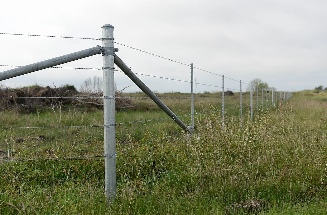

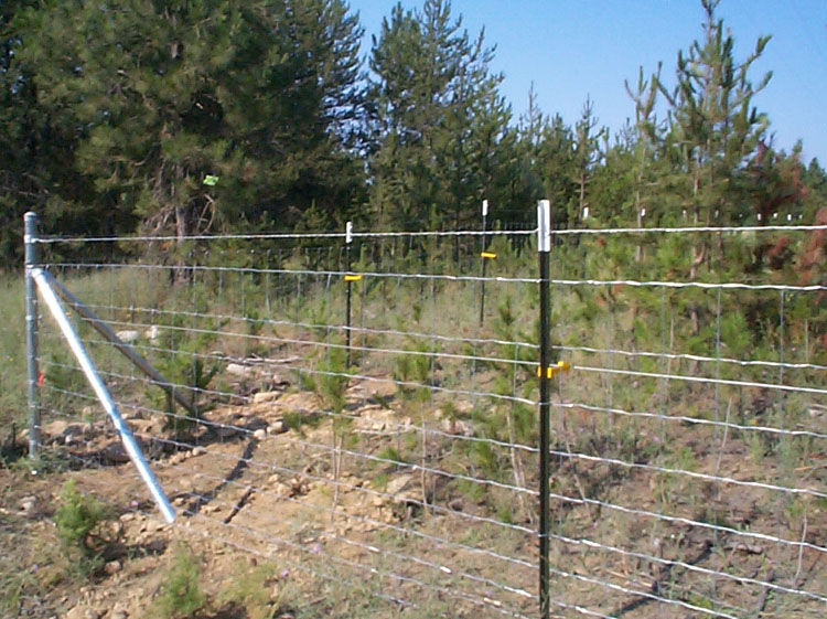

Hey all,
I've got ~800ft of Barb Wire fence I need to install on my property. Its not going to be keeping any animals in or out, I'm choosing barb wire because its cheap and deters trespassers more than other types of fencing.
I'd like to use 4" or 6" galvanized pipe for the corner posts with a kicker as a brace. I see a lot of fences done this way where I am in the high desert of California.
My question to you guys is how deep should I set my corner posts and what size posts should I use? I was thinking 3ft-4ft deep in concrete. Since I'm not going to have any animal pressure on the fence I'm thinking I won't need to run as much tension on the wires as I would otherwise. I just want it to look decent and last a long time. It just needs to establish the property like and keep humans out. I'm planning on installing it myself, auger for the post holes and a gas post driver for the T posts.
Any help or advice you can provide would be greatly appreciated!
Here are a couple pictures of the corners I'm imagining:

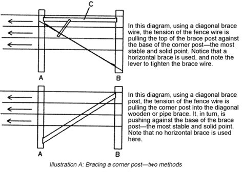

In Missouri we call it the "brace" post. Yes it should be anchored as well and everything tied together with a brace set level or angled and then tied together with twisted wire to create a "box" or "triangle" or whatever you want to call it. When the wire is added the forces are distributed between the three posts.
So wire the base of the corner post to the base of the brace support post?
   / Galvanized Pipe Corners for Barb Wire Fence #8
Brace and wire like this, when using wire to make your "triangle."
If using a solid diagonal, it goes the opposite direction from the wire diagonal.
