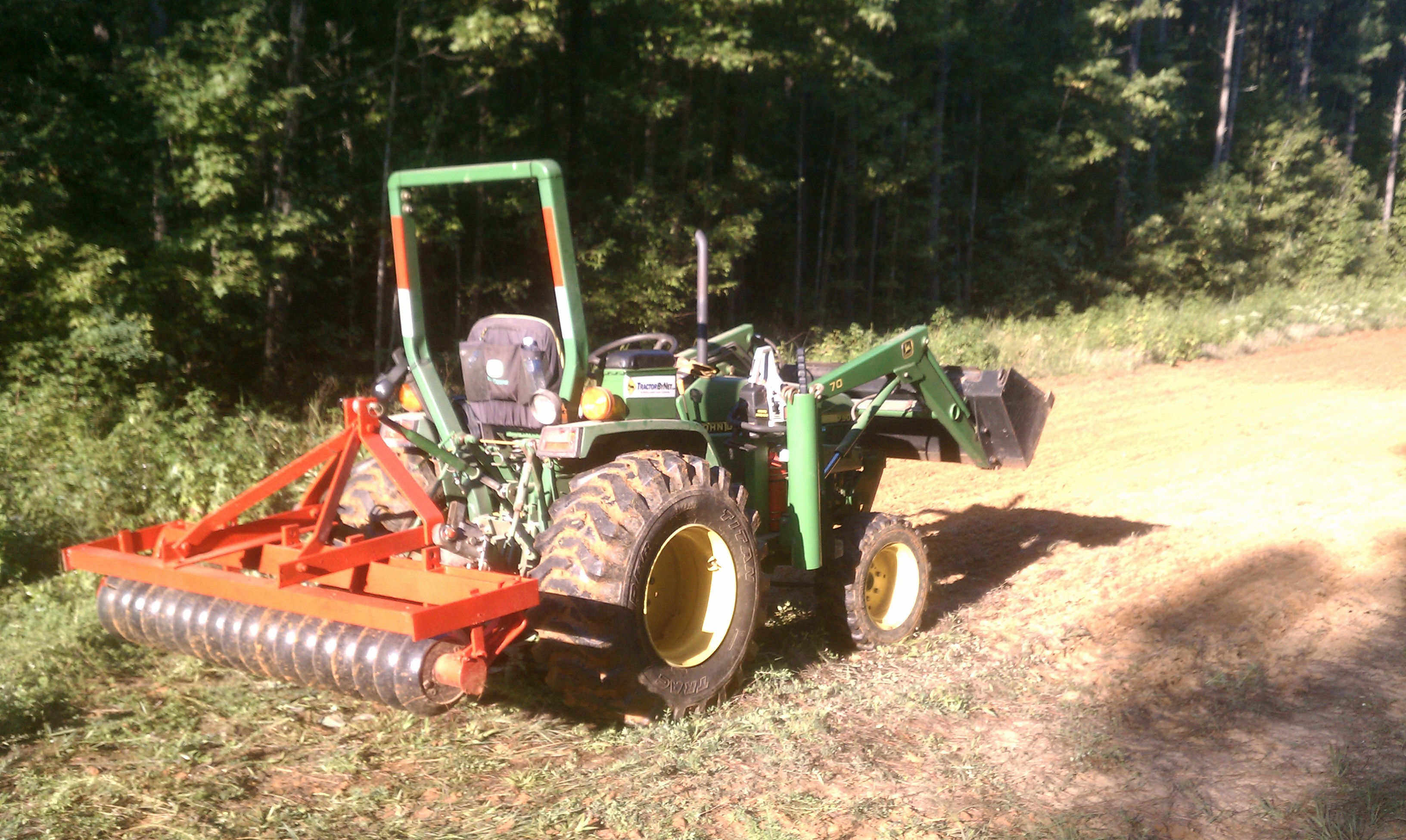

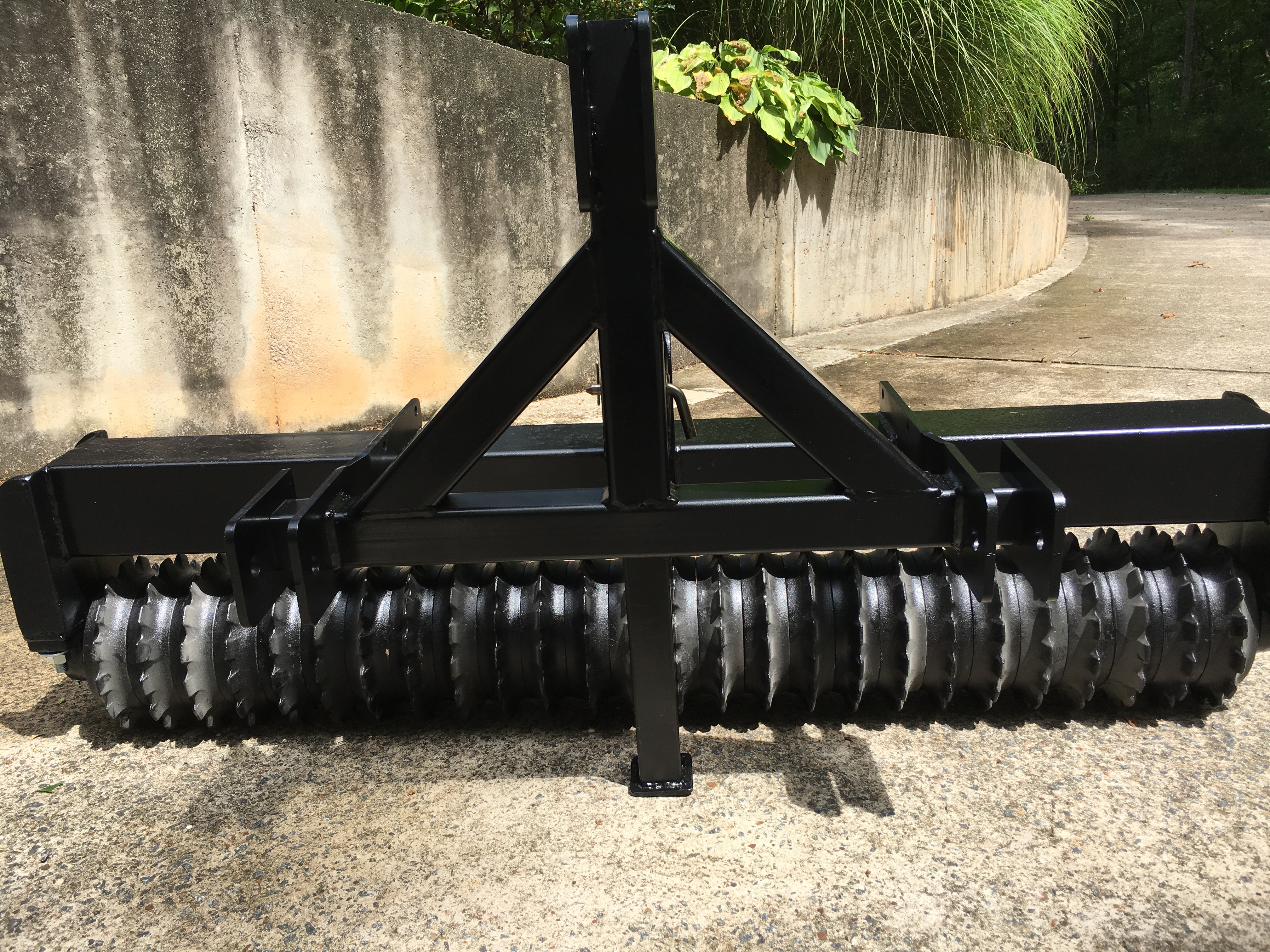

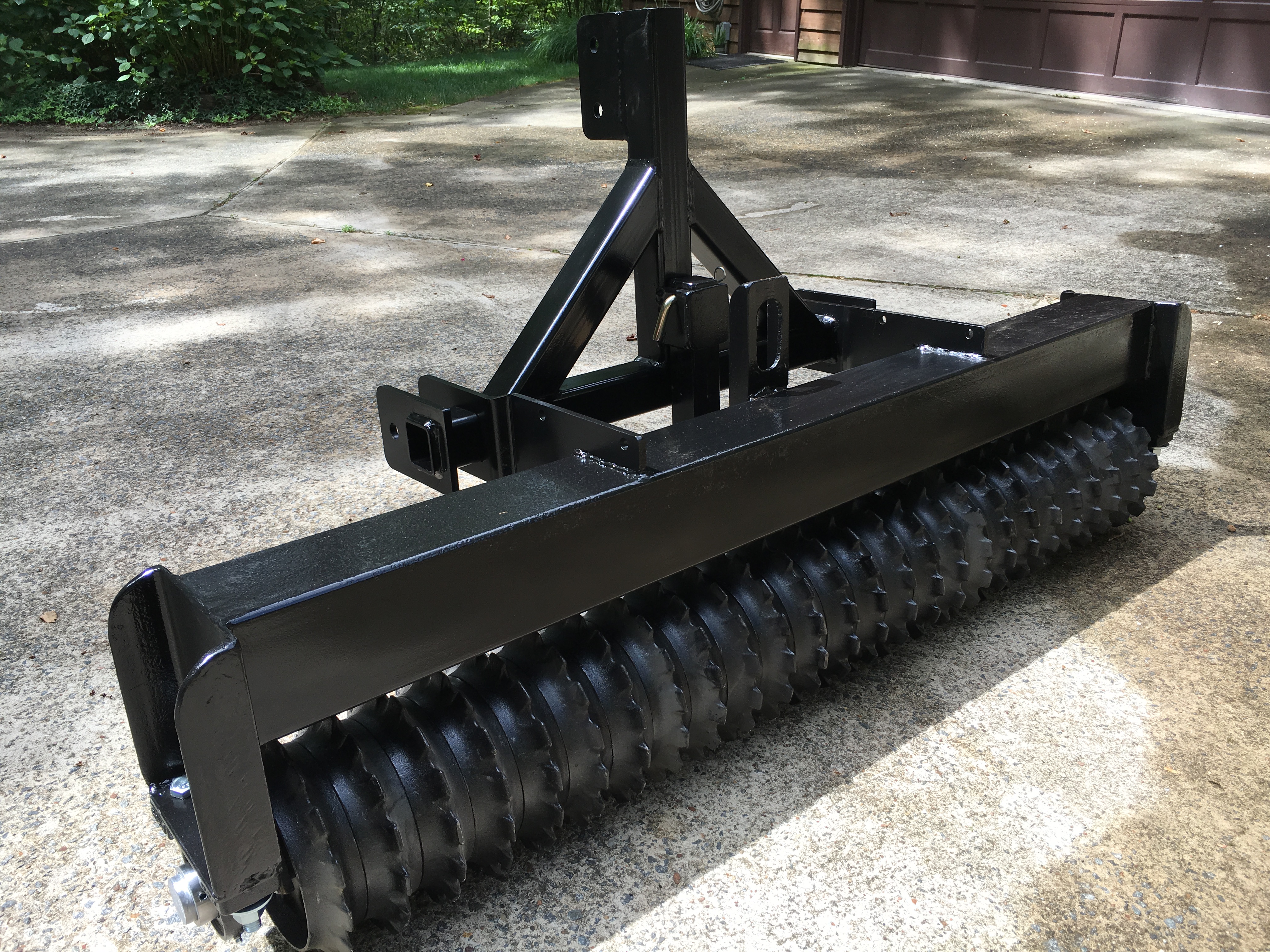

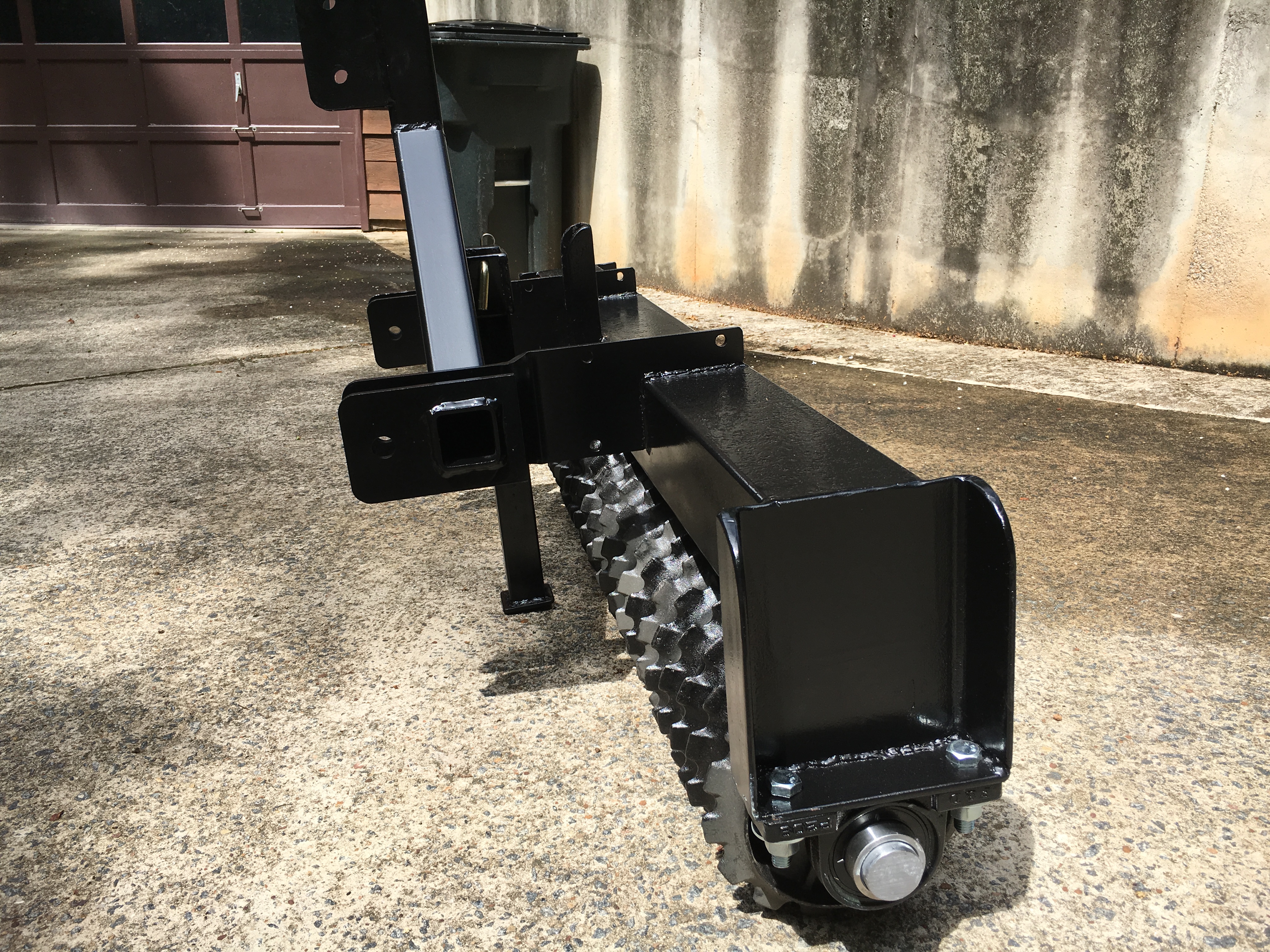

Thought I'd share my cultipacker build. Everything was purchased at my recycle center at .25 lbs except for the wheels and bearings. The center square bar was filled with sand to add weight. Estimated at just over 500 lbs.

It's a metal recycle center so they have everything from cans to steel. Sometimes good usable equipment such as implements or, parts of implements. The 3 point attachment on this cultipacker was a K&M ballast box carrier that someone sold for pennies. It looked brand new. All I had to do was to notch it out and weld it to the cross bar for the cultipacker.

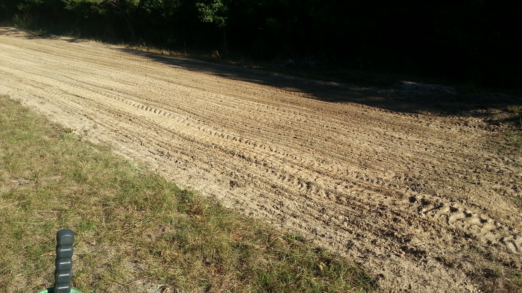

Planted some buckwheat this morning and just beat the rain. Worked like a charm.
   / GA Cultipacker Build
Looks good!

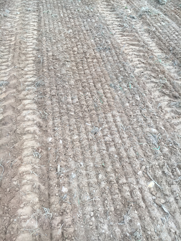

Like predicted, still doesn't cover the wheel tracks but that's OK. In the videos I've seen, even the ones with the 15" wheels don't seem to cover the tracks.

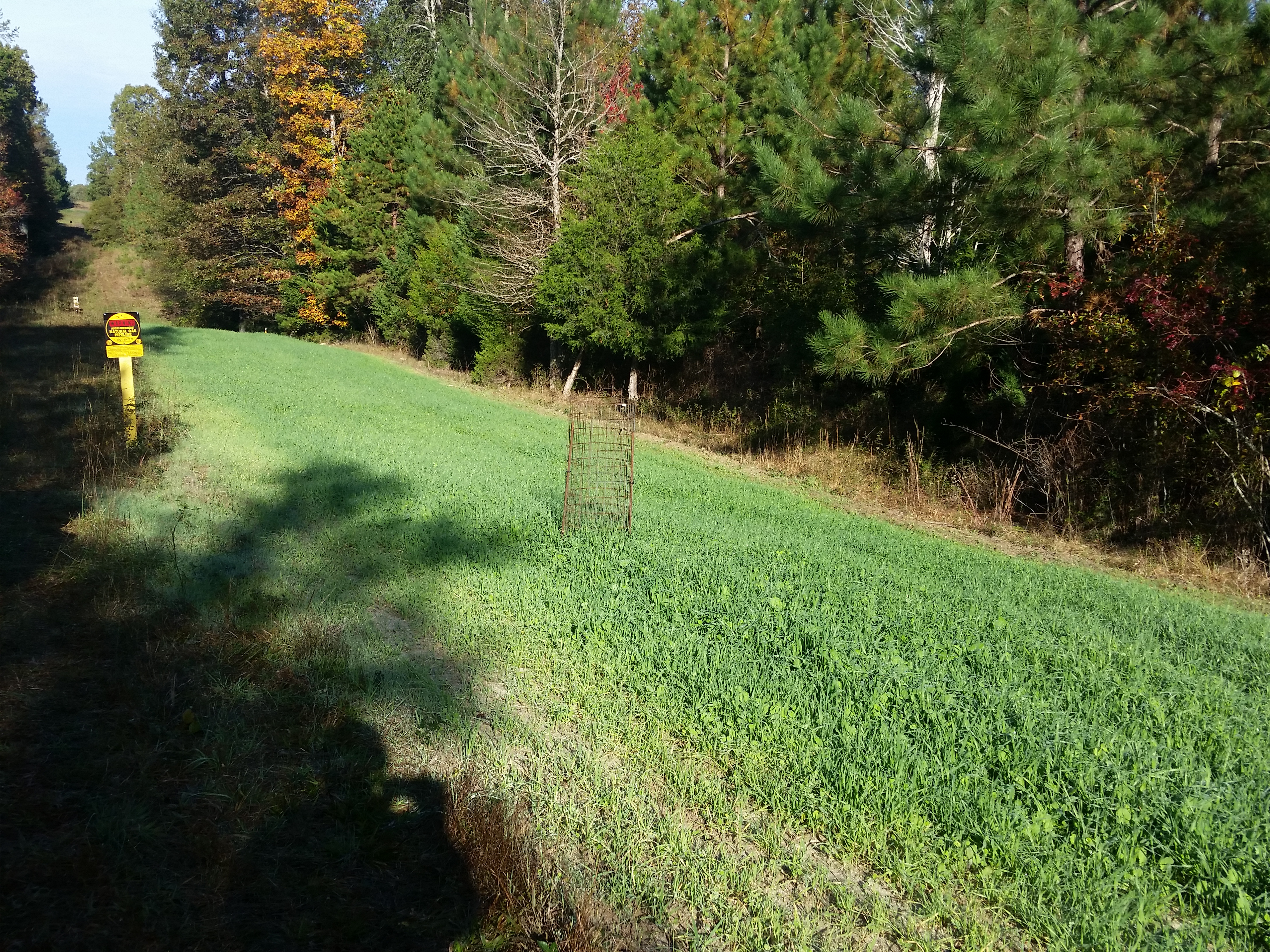

NICE work on your cultipacker! I like it. I have a home made cultipacker as well, but someone else built it. I bought it off CL for $350, I think it was. It's made a little differently in that it has four rippers in front of the wheels. This actually works well, it tends to lightly cover most of the seed, then the wheels pack it down.
Here are some pic's from a couple years ago of a food plot on a gas line where I hunt at.

I'm thinking as mentioned already about adding a couple of tines or something on the front of my cultipacker just to break up the tractor tracks but just enough not to move the seeds around very much. Maybe some slim tines maybe 3/8" rod size about 4 on each side?? Just thinking. They shouldn't disturb the seeds enough to notice and may try something for the fall planting.
