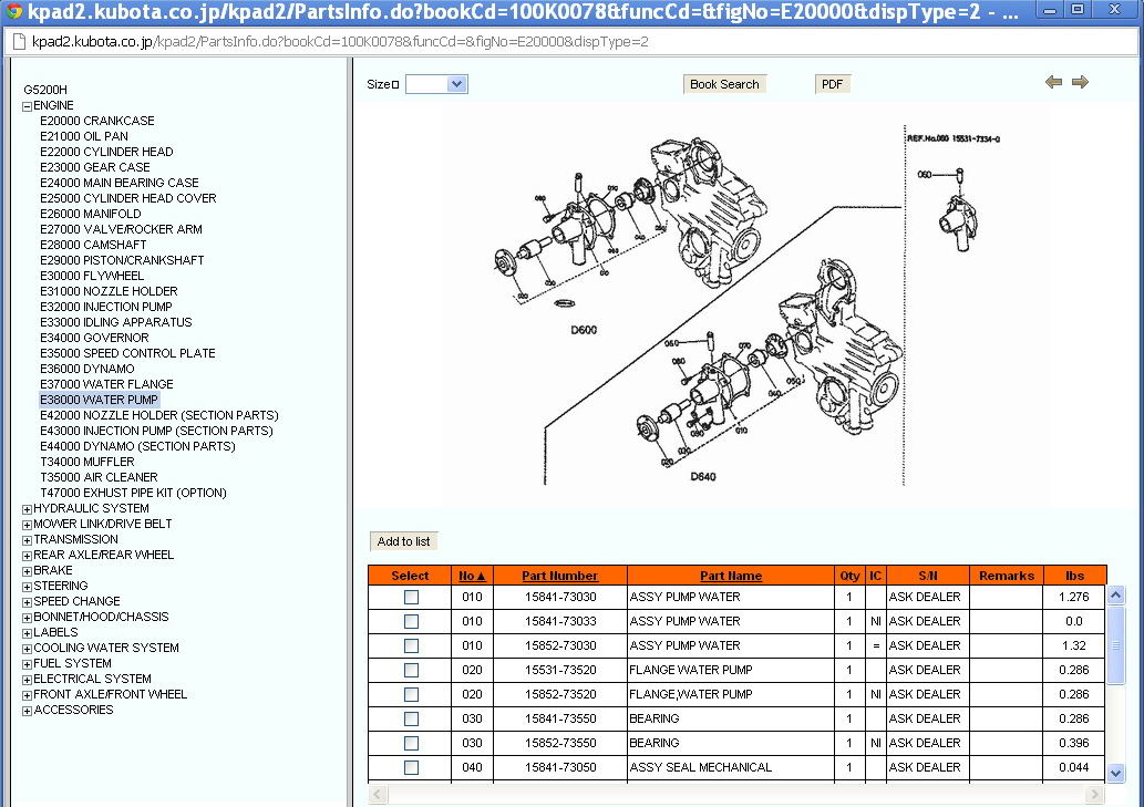

If all belts are tight, I think I'd be looking at replacing the water pump. At least take it off and inspect it for excessive vane wear. Here is water pump illustration from Kubota's illustrated parts catalog.
EDIT: Oops! I don't know how I missed that the water pump was first on your list. Disregard. . . .
