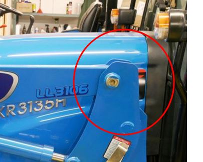

I currently plan on welding the front posts of the new FOPS onto the vertical portion of the FEL mount - making an accommodation for the FEL Controls where they mount on the right. Aft of the circled section below (yes, I know it's not a G3038H).

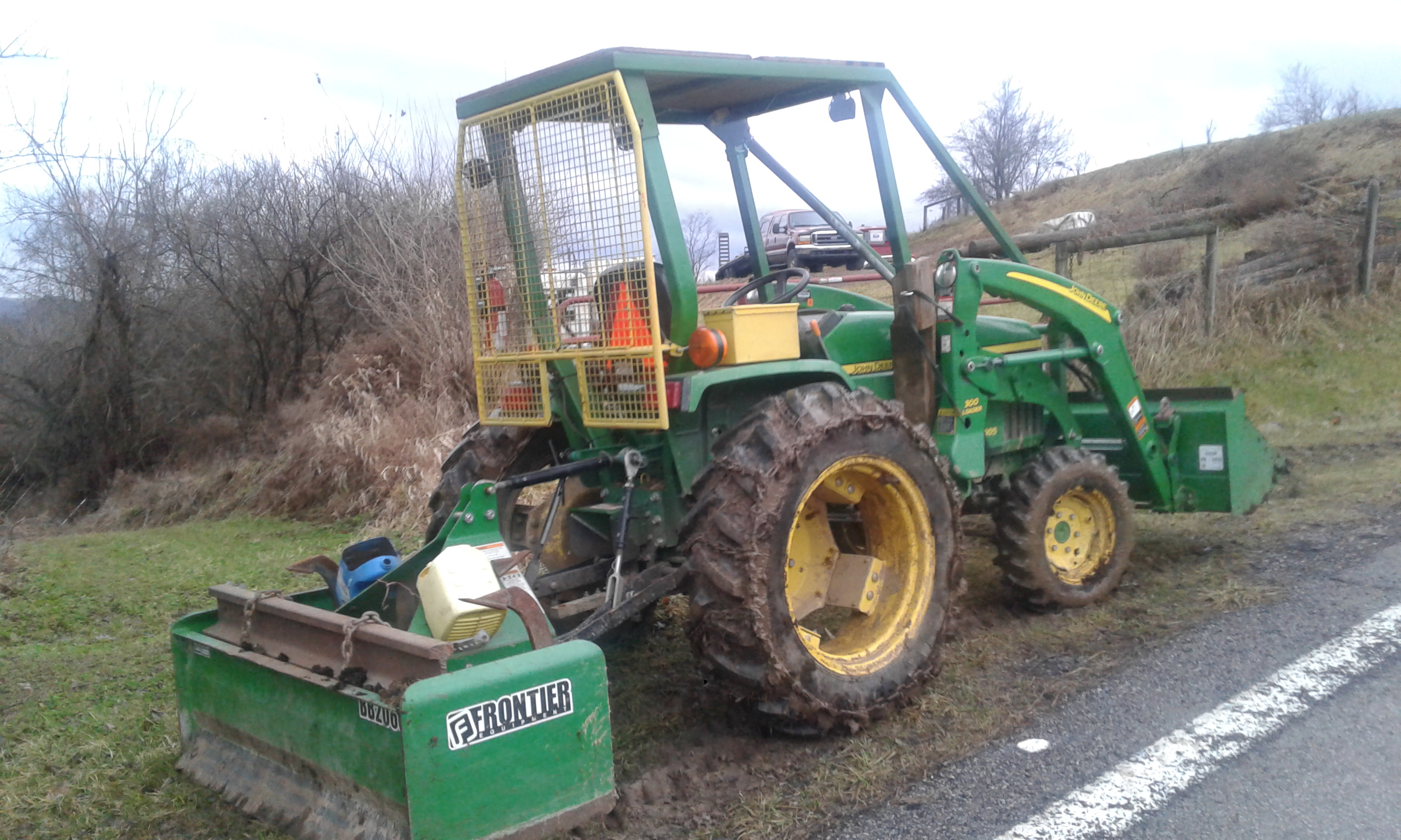

I built a full cage for my JD 3005, fully bolt on, no holes drilled. I only have plywood on the top now, but plan to put 11ga aluminum sheet in the future. 2 limb risers attach to a new brush guard I built as part of the project, the legs that come down at the loader mounts attach to the loader brackets, not the loader masts, as I want the loader to come off as designed without removing cage. The back of the roof hoop bolts into the bolted ROPS side-to-top bar bracket. I built it this way so it can be removed if I ever sell the tractor.

Is there a particular reason you did not attach your front posts to the top of the FEL masts? I see you use that spot for a mirror and I do as well but mine are full sized adjustable golf cart mirrors and I will adapt those to my new FOPS mounting point, unless I am convinced to do something different. LS has a goofy mount for the FEL controls, it is mounted to the right FEL mast - and it's in the way of getting into and out of the tractor on the right side, not impossible, just not very easy to do it without hitting the FEL control stick. If I attach to the FEL Mast, I will, of course, have to re-position the FEL controls.

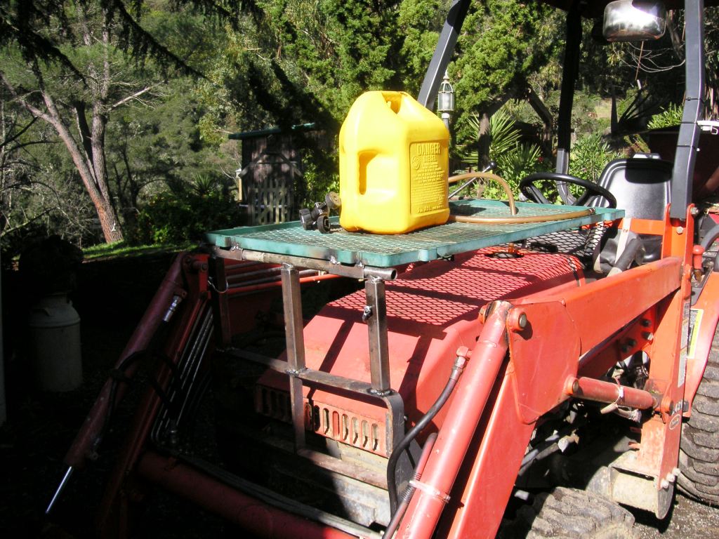

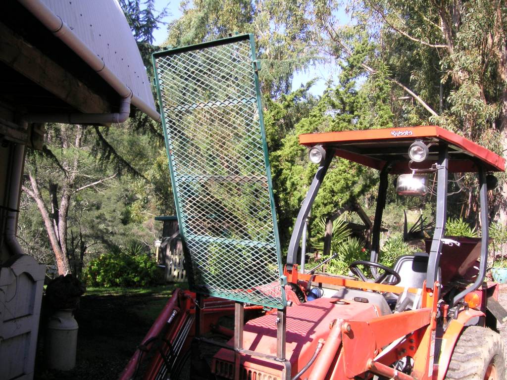

While I like the idea of the brush guards, I don't really need them and so will likely not use that part of the idea. They might be in the way of the tote shelf I will be putting onto the cross-bar between the two front posts as well. It is like the one I built for my B21, except the hinge will be on the aft end due to the hood opening to the rear on my LS.
You will notice in the photos that Kubota mounts their FOPS front post to the FEL mast via welded brackets and grade 8 bolts. I may use this method as well. Sure like to see your photos - did you drill and bolt to the ROPS?
