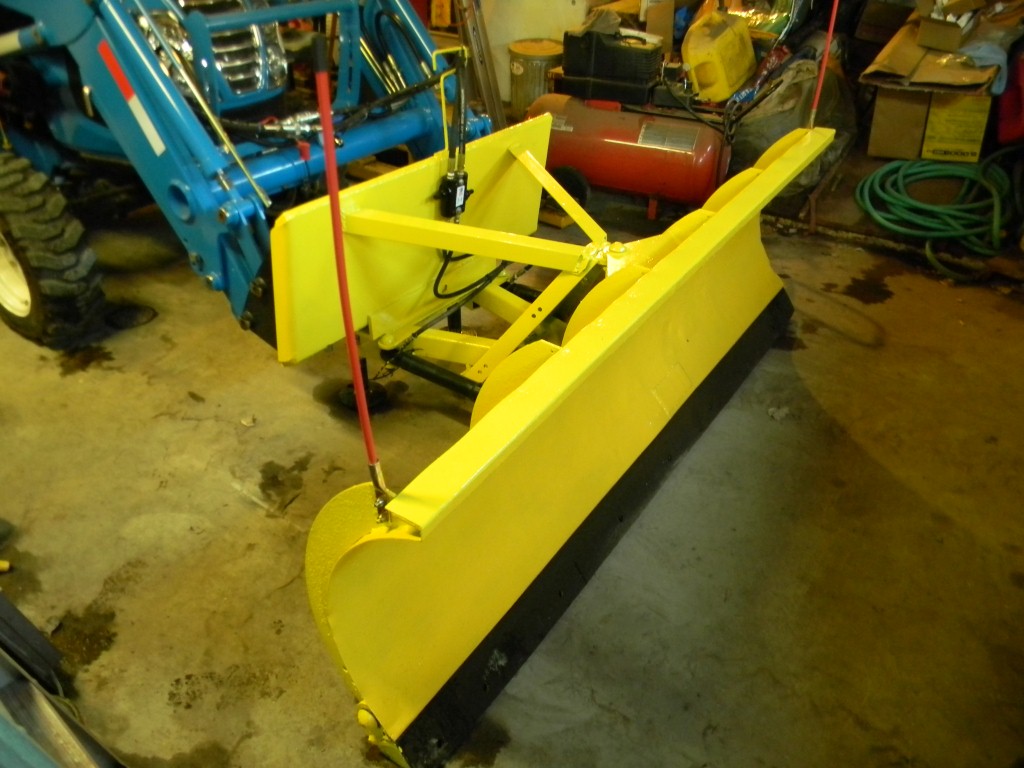

I have the XR3037HC and use both a 7'6" Power angle truck plow I adapted to a QA plate and a 7'6" snow pusher.
