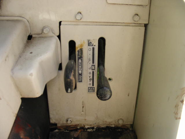

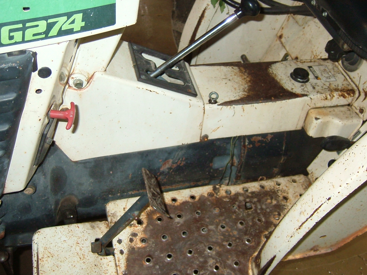

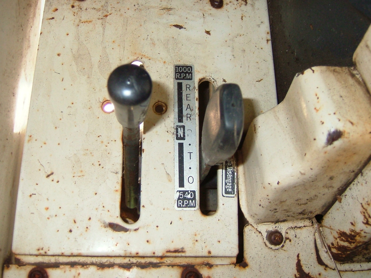

You must have a "new and improved" model. Here are a few pictures. The one with the levers is upside down the round knob is the PTO and the Flat one is the 4WD control, so the PTO control is closer to the fender. The one with the dash shows the toggle switch and it is lettered "PTO Clutch". The last one is where I think the feathering control should be.
Maybe some more people can weigh in now.

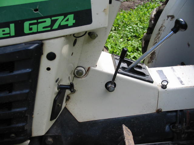

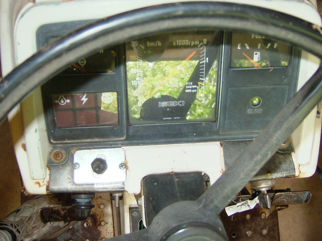

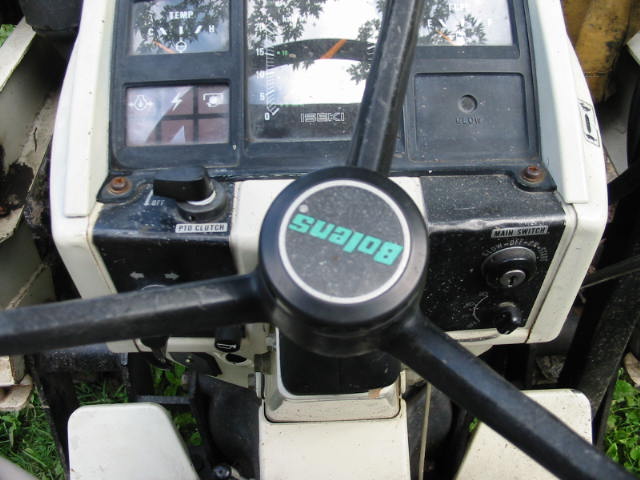

Coolnik - I didn't think of photos till I saw yours. So here is my attempt.

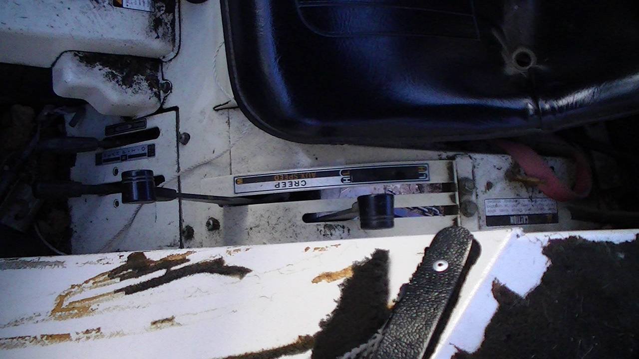

Hello,
I am a brand new TRACTOR owner. ISEKI G274.
I have piloted cars, motorcycles, boats, airplanes and horses .... but this is the scariest thing I have ever sat on....but it is getting better with familiarization and a sensitive left foot.
To add to the confusion .... I seem to have an extra lever marked AUX SPEED and CREEP. I have the 3-speed, and HI-LO range figured out. But the AUX speed lever is ther only thing I haven't figured out ..... is this the equal to the feathering mentioned here? ...or does this allow a faster/slower range of PTO speed with slower engine speeds?
There are a couple of other ISEKIS locally but none have this AUX speed lever.
Thanks for your help.
MARTIN
