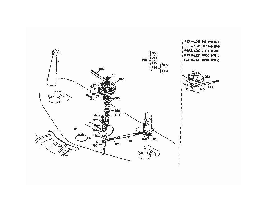

My deck belt broke. No manual, so I'm just disassembling what seems logical. So far I have everything disassembled except for the middle blade/pulley/gearbox combination. I need to purchase a 1 3/16 socket to get enough leverage to remove the bolt holding the center blade on (monkey wrench wasn't cutting it). I'm assuming that once I get that removed, the pulley/gearbox will disassemble and allow me to attach the new belt. Does that sound correct to anyone who has done this before?
Also, I noticed some ball bearings (about 1/4" diameter) that came from the center pulley (the one attached to the arm tension bar and spring). I removed the pulley and flipped it over and tried to get the bearings back in. I can get them back in with some coercion, but they just fall out again. There's now some wobble to this pulley. Any idea if this is this going to ruin my belt in 1day/month/year?
I'm looking around and i cant find any bearings listed in the parts diagrams. I'm wondering if I order a new pulley if it will come with bearings and everything already attached or if will just specifically be the pulley part. I suppose a call into Keller is probably in order...
Below is a highlighted picture for clarification:
Thanks for any input.
-Josh

Jim, thanks! I completely overlooked that option. Much easier than the path I was headed down. Advice much appreciated.
-Josh
PS: if anyone has any opinion on the bearings in the pulley, feel free to chime in. thanks
   / G1900s 48" mower deck belt replacement questions #4
The parts list for mine shows individual bearings:
So I think the pulley may be just a pulley; not an assembly.
But maybe they changed that - I'd call Keller.
Good luck!
