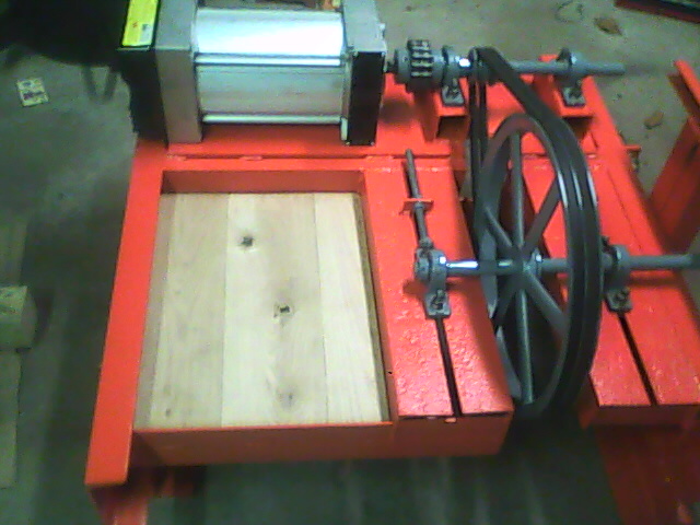

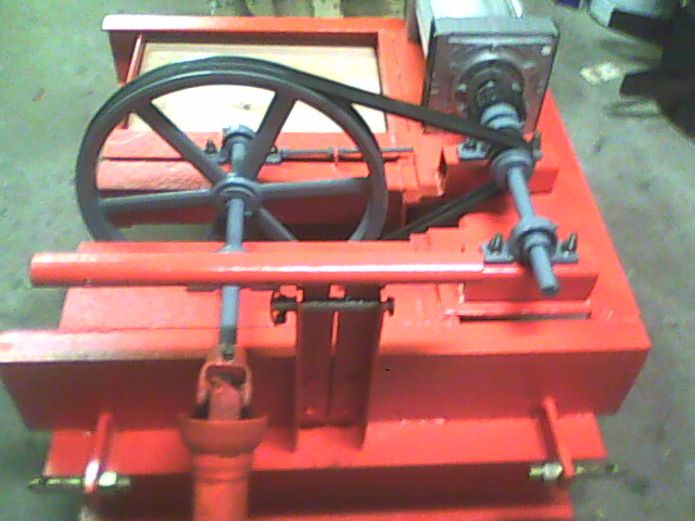

I have a 1200 Ford that I have owned since 1983 and have replaced the glow plugs twice. I do not think they are fused. Try your test light to ground on the battery to test for power,if it light circut is working. Now for a neat trick, hook the test light to the positive side of the battery and touch the top of the glow plug. If it lights the glow plug is good, if not the plugs are bad. I had no luck with the Ford replacement plugs only lasting a year. Try Walts Tractor Parts in MO, half the price and have been in there 4 years now. Here is a beltdriven generator I just finished and will power with my 1200.
