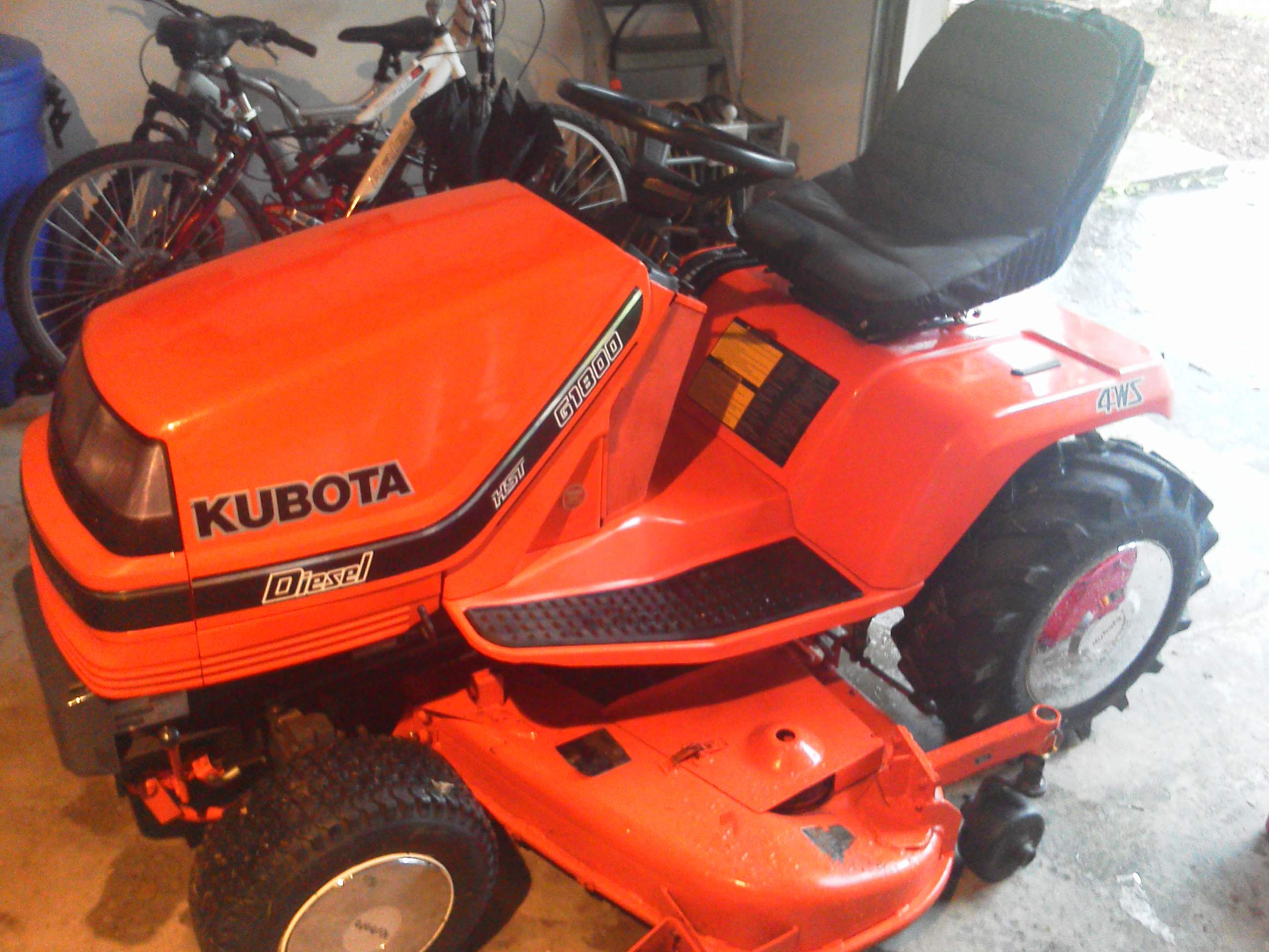

I just bought a G1800-S with 420 hrs. It was fairly dirty and had not been used in a long while (vendor said that it had been tied up in an estate for 10 years), but I could see that it was in good shape otherwise. The mower suffered from the intermitant problem where it would not shut down when turning the key to off. This required a new combination box which was expensive to replace. The mower deck had a small crack near one of the rear caster wheels which I had welded. I also replaced the rear turf tires with Tru Powers as I have steep hills to mow with a lot of obstacles and the tractor has very little grip with the narrow turfs that come with the 4WS version. It does not slip at all now, even on steep wet inclines. I put metal valve stems on the rears just in case I decided to fill them with Rimguard, but I won't need to as the Tru Powers grip well enough on their own. I also had to replace the mower blades. The machine was very expensive to service. There are just as many filters etc as one would find on a large tractor.
In terms of its performance - as a mower it is excellent. With the 4WS and 54" deck I have an uncut radius of 12", if that, so there is very little need for trimming. The power is more than adequate to run the mower deck in tall grass on hills. The ride with the Tru Powers and the 4WS is a little rough though. All in all the machine is excellent, but likely not as refined as a new GR. I could have bought a new X300 for what I paid for the G when you take into account what I spent to purchase and service the machine, but I dont think that you can compare the two in terms of ruggedness. I hope to have the G for another 20 years.
   / G1800-Still a good choice? #6
Here are some pics. Please note that I touched up the paint on the mower deck and repainted the wheels. Otherwise all it needed was a clean up. I would definitely recommend the G1800-S as a mower.

jcaledon, you sure have that G1800 looking nice. The aggressive ag tires probably really add to the traction. I've seen a couple on craigslist in the Dallas, Tx area that fall at both ends of the spectrum. The first one below looks pristine and the 2nd one looks like one you'd offer much less than their asking price.

JCaledon: That's a nice machine! My G1800 is a bit rougher but works like a charm. I'm in Ottawa and I was getting severe corrosion under the rubber mats. Water and salt was really doing a number on the sheet metal so I took off the mats and replaced them with aluminium anti-skid plate material cut and bent to fit, I bought the tractor used at 193 hours and now with 500 hours the only problems I've had are original front tires weather cracked. There's a known problem trying to get the front wheels off so I left the wheels on and installed tubes, problem solved. I also had the engine shut off solenoid go. Replaced the solenoid with a manual pull shut off, again problem solved. I change fluids and filters as laid down in the manual and regularly grease every fitting.
