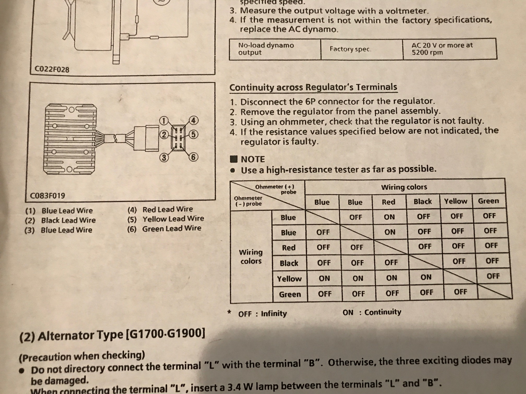

You might also check under the radiator screen under the steering wheel. There is a voltage regulator tucked away under there, right behind the dash. I had the dynamo (basically an alternator) go bad, which then seemed to cause the voltage regulator to fail. Obviously you need about 13-14V coming out regulator to keep the battery charged. I have attached a pic of the voltage regulator check. Basically you do continuity checks with a multi-meter. VR_Checks.JPG

You might also check under the radiator screen under the steering wheel. There is a voltage regulator tucked away under there, right behind the dash. I had the dynamo (basically an alternator) go bad, which then seemed to cause the voltage regulator to fail. Obviously you need about 13-14V coming out regulator to keep the battery charged. I have attached a pic of the voltage regulator check. Basically you do continuity checks with a multi-meter. View attachment 560566
