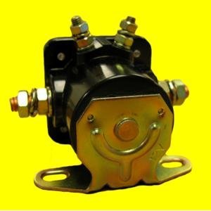

Have you thought about using a relay in the start circuit, your switch voltage should be enough to activate a relay similar to the ones that Ford had mounted to the fender in the '60's like this one.
   / G1800 ignition switch
Milkman, thats exactly the type switch I first considered. I bought a NAPA 12 VDC, 15 amp pushbutton switch and installed it. What I like about it is that I can cycle the glowplugs and instantly push the starter switch when the glowplug timer stops, keeping them from cooling and providing an instant start. If the switch I used holds up, I'm good to go. If not, I may put a starter switch like the one you posted inline and use the switch to activate it.
