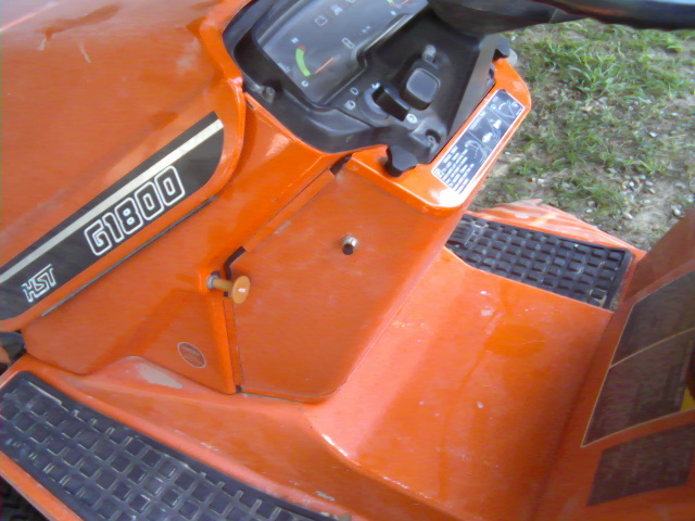

There is a fusible link down near the starter. If it is blown, nothing will work. If its contacts are dirty, it will act like your symptoms. When you turn the key to on, do the GEN and OIL pressure lights illuminate? If all panel lights are out and no glow plug light or attempt to start, that is usually the fusible link. Your problem sounds like the fusible link is still okay, but may have intermittent contact.
I got so tired of my bad starter switch on my g1800, that I put in a hot wire to the starter with a intermittent contact switch. That will start my tractor even if the fusible link blows.
Here's a link to your G1800 electrical diagram.
I've attached a photo of my little starter switch I bought at a NAPA autoparts store.

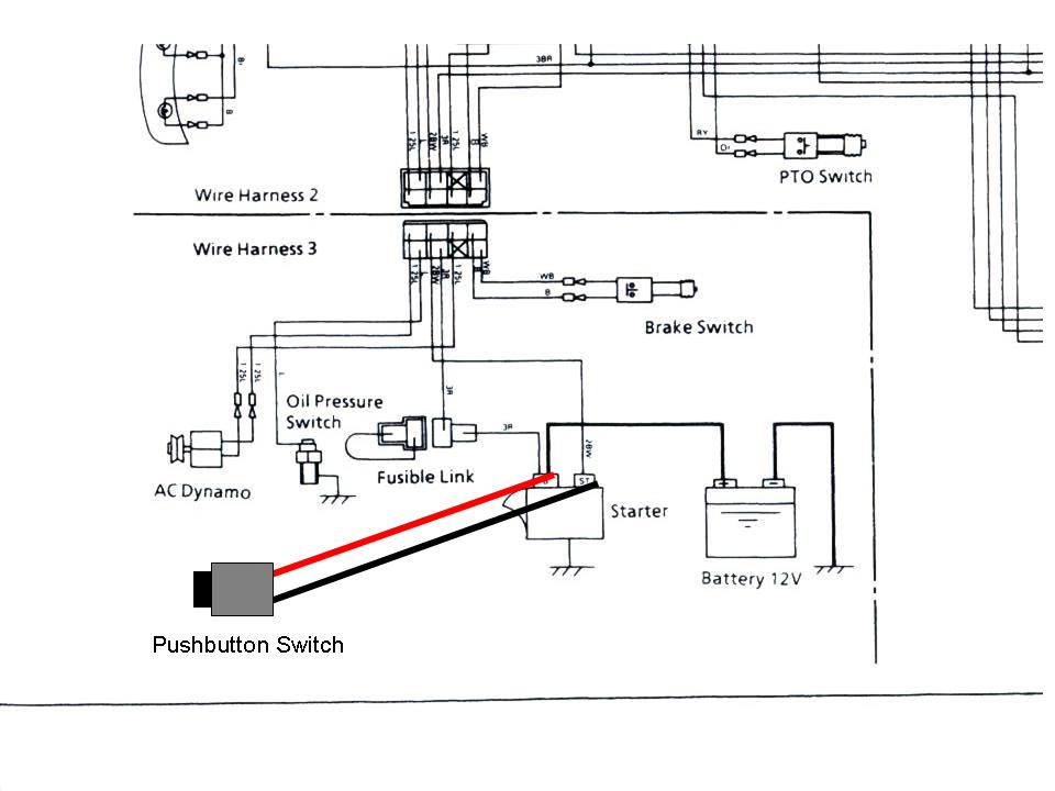

Jinman, How did you wire up your starter switch?
that looks like that may be what i have to do.
but i wish my gauges would work
   / G1800 electrical problems #10
Steve, I didn't want to do the hotwire as I did in the attached diagram, but no other way worked reliably. I first bypassed the combination box relay and tried to use the regular ignition switch. That was unreliable. It worked sometimes and didn't at other times. I found the switch was dropping voltage across its contacts so that my 12.5 volts dropped to 10.5 volts across the switch. So, I just wired in a jumper between the hot wire at the starter and the starter solenoid through the momentary contact switch. The switch is rated for 15 amps. It's a NAPA part number ECHPP5007.
Anyhow, if the switch ever fails (welds its contacts), the starter will just keep running until I disconnect or cut the wire. If you put a spade male/female inline with one side of the switch, you can easily disconnect without having to take off the vent cowling under the steering wheel.
Also, you need power to your fuel pump at all times, so if your electrical problems include not powering the fuel pump, this jumper and switch may not prove to be a complete solution.
