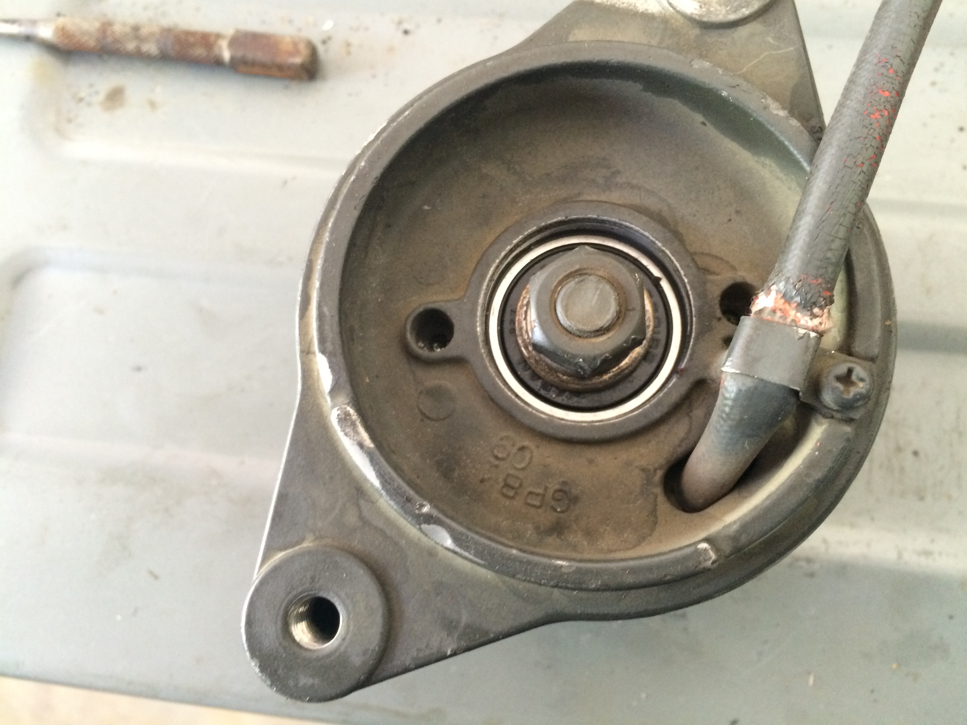

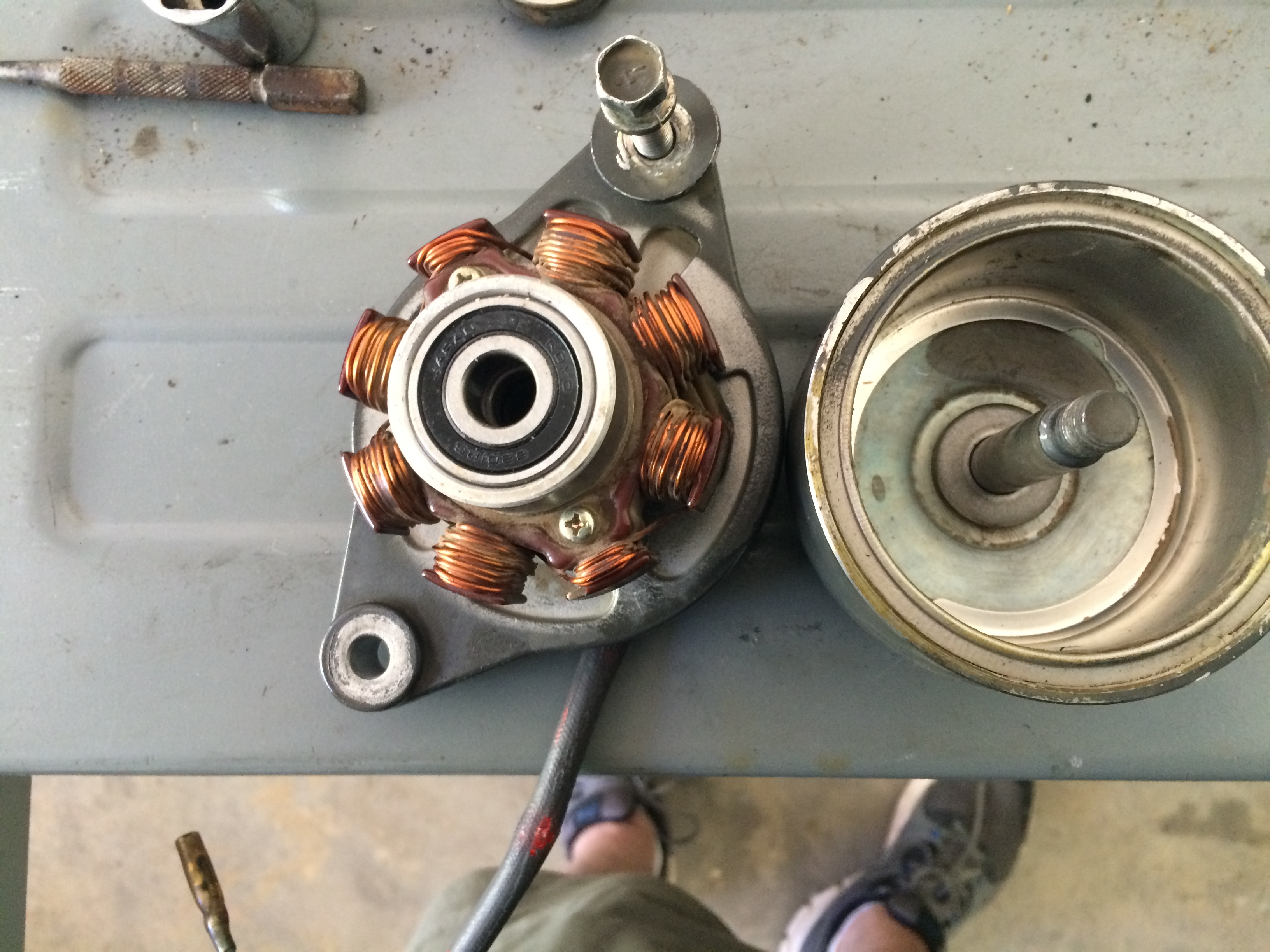

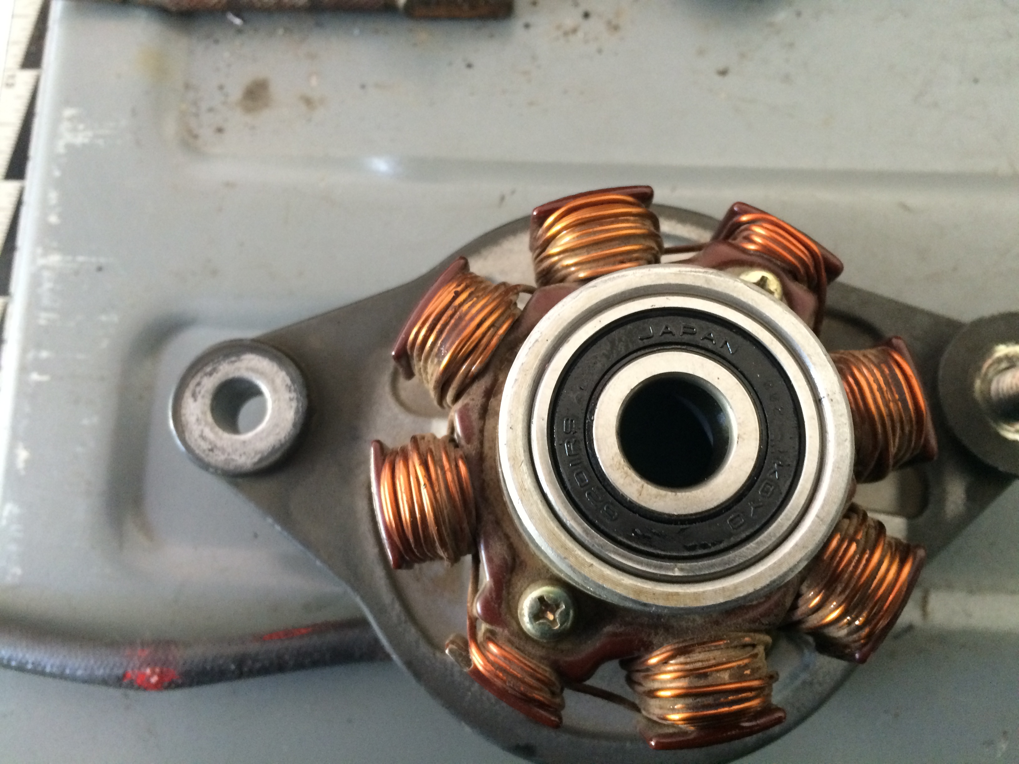

Great thread. I just replaced the bearings on my Dynamo for a Kubota G1800. The parts diagram said three bearings, but there were only two when I took it apart. Not sure? ? Prett easy and $7 per bearing from local Kubota dealer who had them in stock. Cleaned up bearing surfaces with emery cloth and used light weight oil to get them to go in easily.
Some pictures since those are better than words.
First picture you are looking at the plate (opposite side from stator) and can see the new bearing in the bottom of the dynamo already installed. The bushing and 2nd bearing in the picture go on top of the already installed bearing. You tap the bearing in until it rests against the lip in the hole.
Second picture. Both bearings and bushing installed.
third picture. Bearing installed on stator side.
fourth picture: Back together. Washer, lock washer, and nut rest on top of bearning. Bearing is pressed unto lip inside plate.
