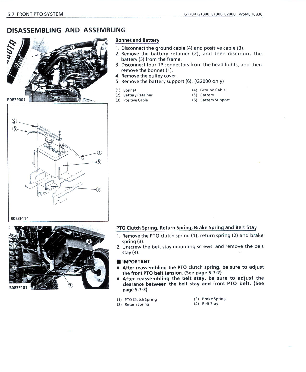

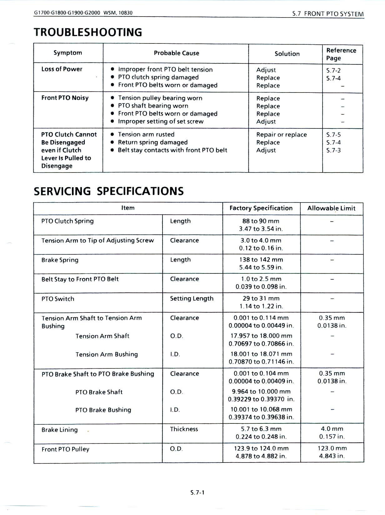

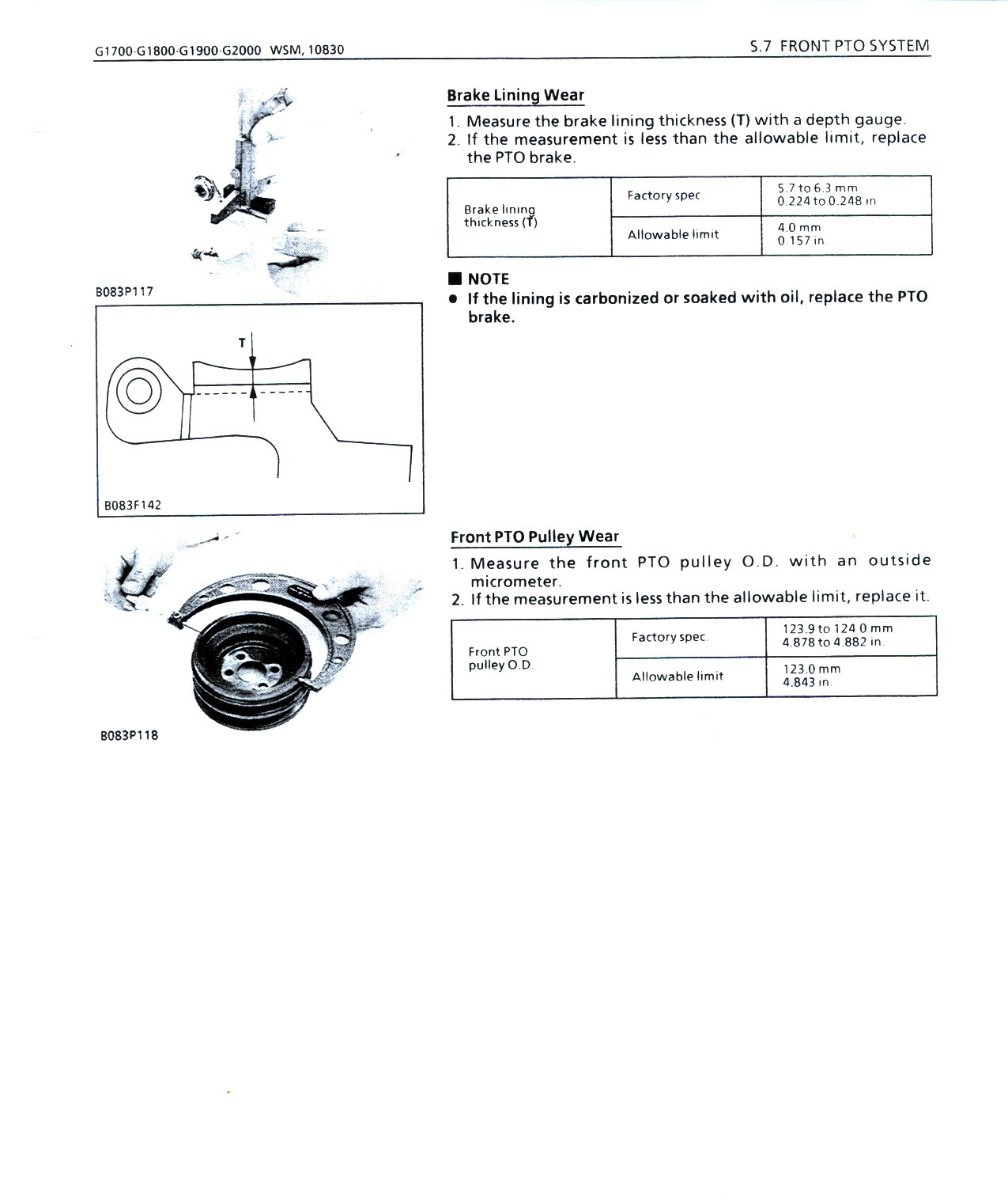

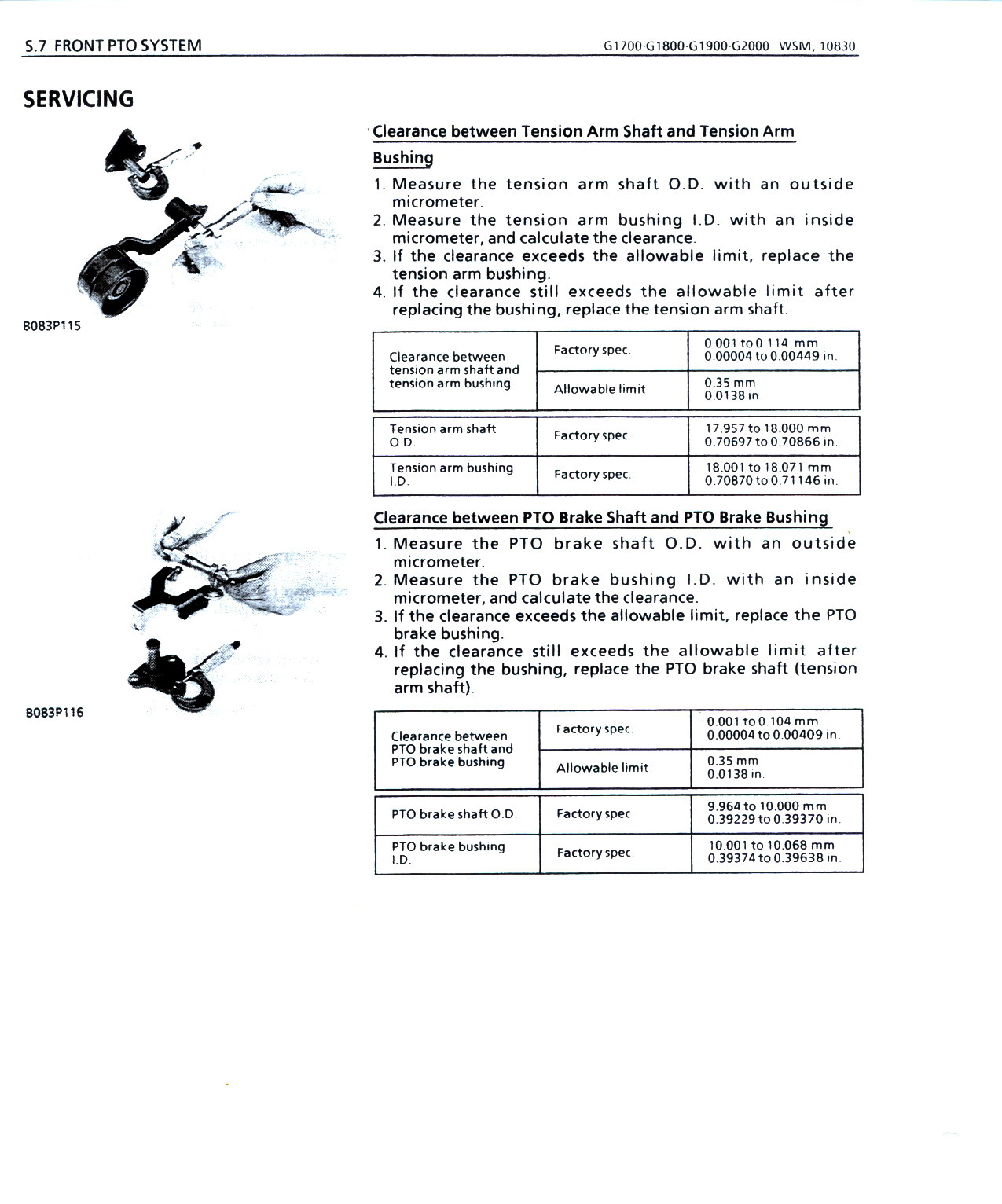

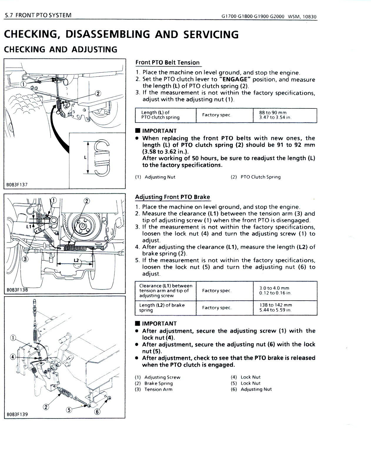

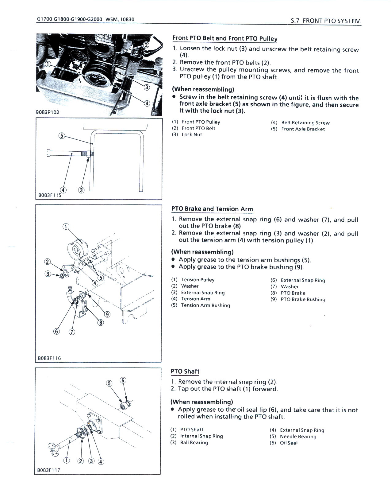

Here are your maint man'l pages.

WOW,thx heaps jinman,when it stops raining here(wagga wagga) ill set all the adjustments as per the manual and hopefully that will fix it,thx again m8, cheers phil

Phil, make sure that engagement pulley is not flopping around on its axle and thowing the belt off-center. Also make sure your brake is working to stop the pulleys as you disengage. All that stuff is on the pages, but can be easily overlooked.
   / G1800 belt problem
hi jinman, ur a legend,thx alot,it was the 2 springs,thet were out of adjustment by 20mm,now the belts stay as they should,sweeeeeet,cheers phil:laughing::laughing:
