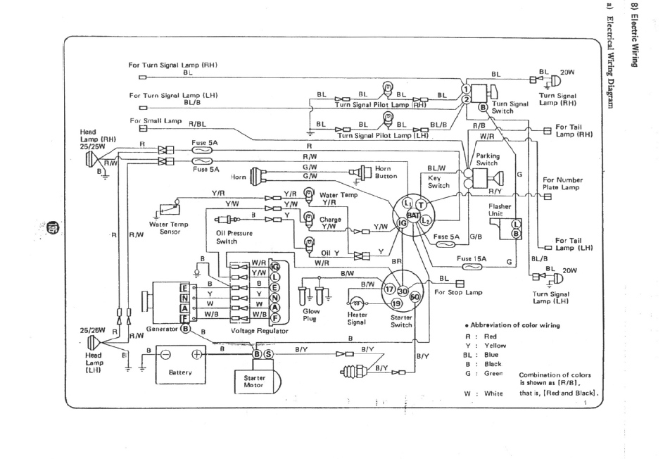

Greetings all;
When I bought my tractor, the prior owner had told me that he fried a couple of the ignition wires due to a fault in the starter/glow plug switch. The evidence proves this to be correct as I did find one wire melted along the entire length of the steering column. Prior Owner rigged up a bypass for that issue that seems to be working today, but doesn't quite meet my standards. So I was hoping someone might give me some advice on recreating a wiring harness for my tractor, or ideally locating a new one. I'd like to know if there are a list of wire sizes/colors available. Other than doing a strand for strand replacement, is there another way to go about this. Is there a chance that these harnesses and switches exist on the shelf somewhere? As for the cause of this, I am pretty sure I traced it to an issue with the battery post touching the instrument panel shroud.
I would like to replace the starter switch as well as a missing charge lamp on the dashboard.
Thanks all for any advice you can offer. - Mark

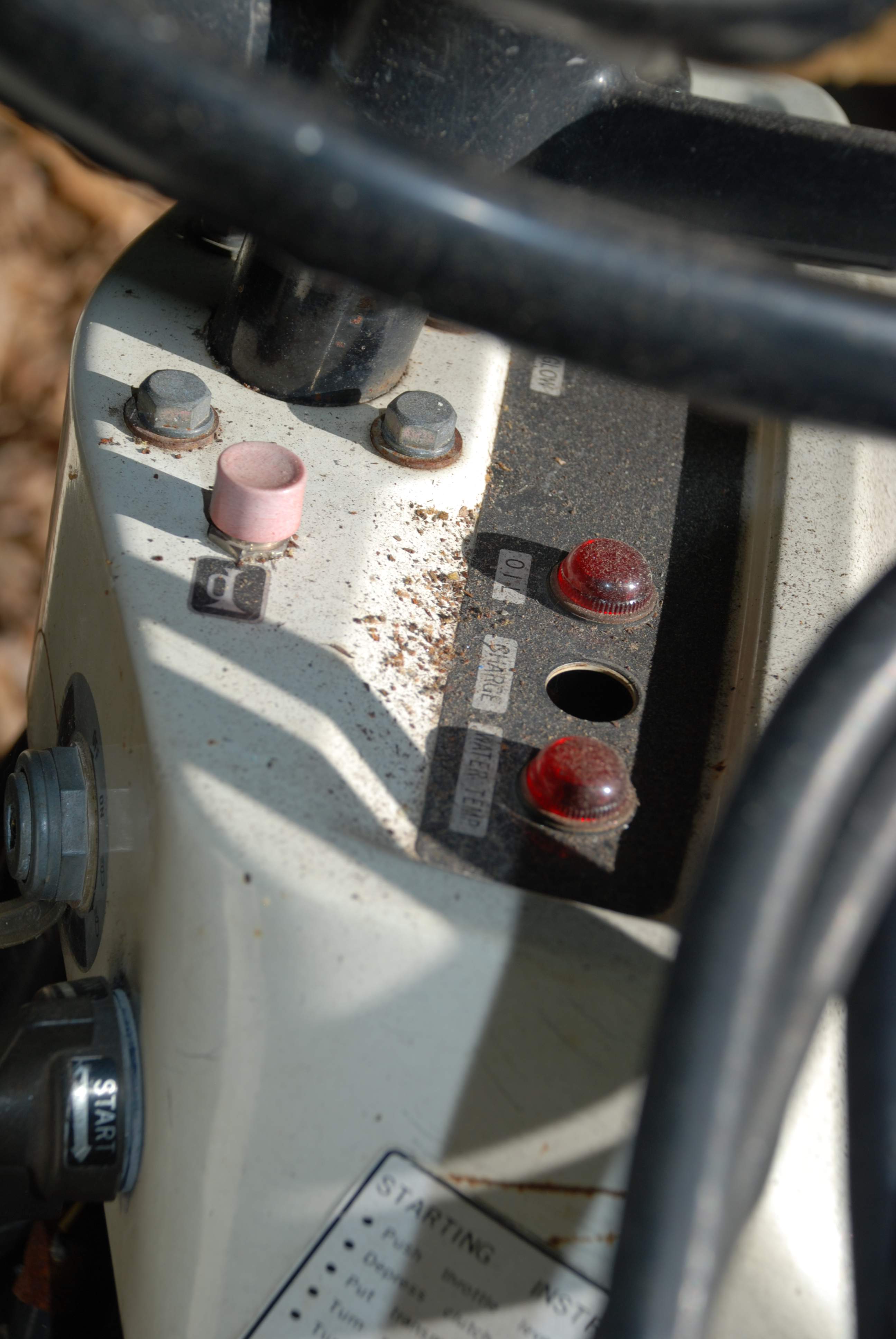

Hi Mark, I am going to look through my service manual, because I believe that I have all of the wiring diagrams, also I had to replace the exact same warning light, and I bought it from Sam's Bolens. Sam's Bolens It came with the red lens, the assembly, the bulb, and the wires. I have also seen the starter switch on eBay, and I will take a look. I can also look at my wiring, and let you know what it looks like. Also, just FYI, I drained and flushed my radiator today, and found where the plug is, you have to remove the grill. I'll see what I can find tonight as far as the wiring diagram goes, and I'll post it if I can find it. I also adjusted my clutch today, and it was actually pretty easy, and it was grinding, and now it works perfect. It is the original clutch that came with the tractor. I post back in a bit..

This is a photo of the dash warning light/charge light that I replaced and the decals that he made for me. I also replaced the steering wheel with a new Yanmar aftermarket wheel, since I could not find a new Iseki wheel, and I was not happy with the sparex one that I had purchased. I'm attempting to locate the wiring diagram right now, and i'll upload it when I do..

I found these two diagrams in the service manual that may help, but they are a bit technical:
   / G154 / TX1300F Wiring Harness #6
I have the complete wiring diagram pasted on the underside of the hood! I wonder if they came like that?

I too have this under my hood. Didn't find it until last week. Before I dropped off the tractor to the mechanic last week, I unwrapped the entire harness. Decided that it will be easier to replace the bad wires and then rewrap the harness.

A few years ago when I bought my TL 2300 my wiring harness was also fried. I ended up replacing the whole thing with a new one from Rainbow. Took perhaps a month to get it but worth it rather than Mickey Mouse type repair.
Funny later but looked and looked for a schematic and ended up purchasing a parts manual that included it. Later, I was working under the hood and looked up........there it was
