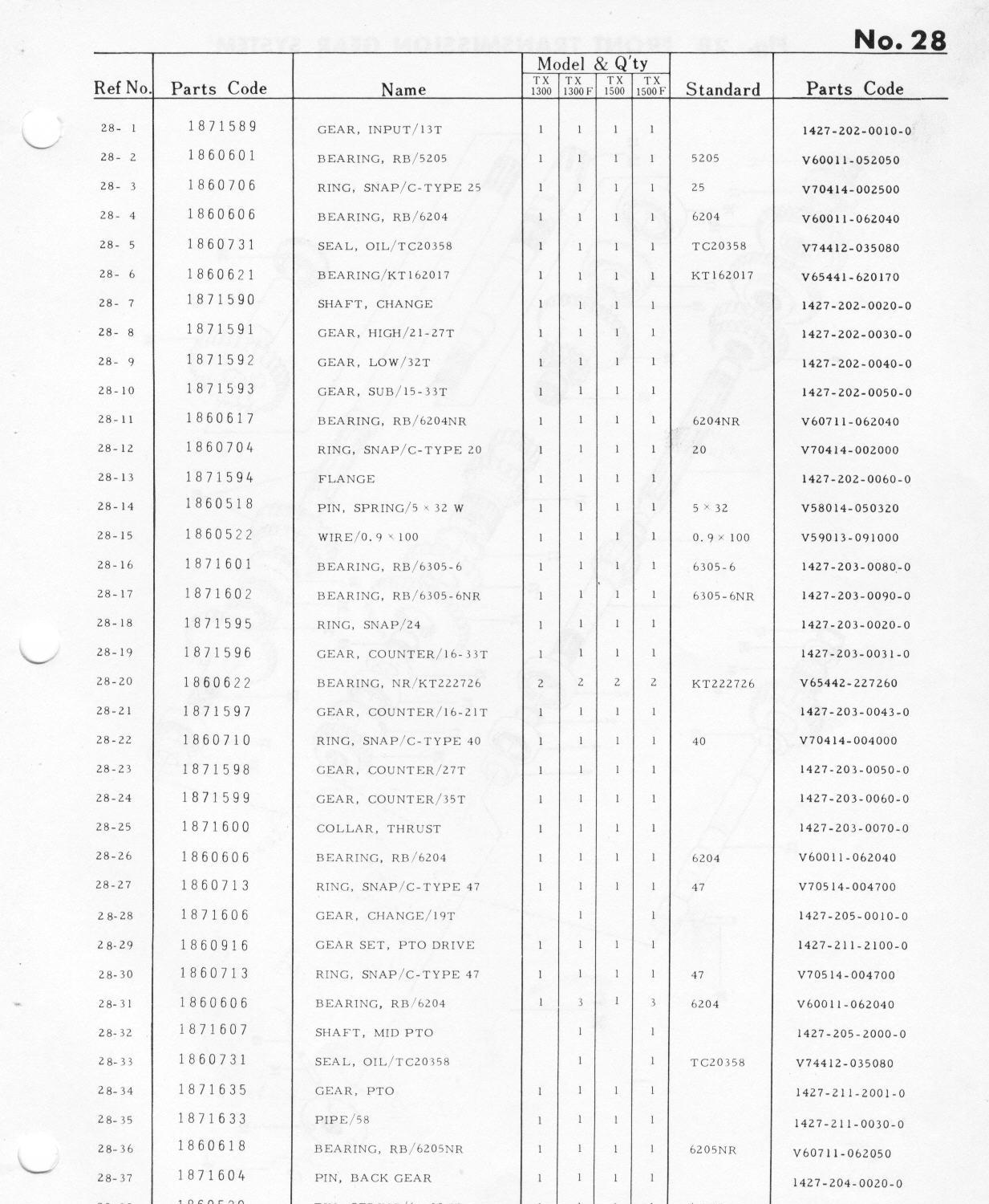

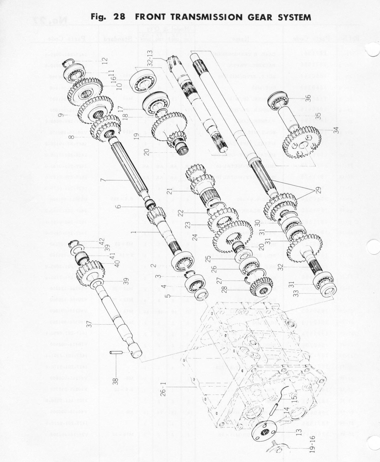

My G152's pto shaft moves out when I use the slasher or post hole auger. From what I understand there is a ciclip that holds it. If so, this has been broken. Does anybody know how hard it is to replace and where I can get the right one?
Thanks, Geoff
   / G152 pto shaft gets pushed out. #2
The Bolens G152 is basically the same as the Iseki TX2140 & TX1300 all built in the same factory/same design with most items interchangeable or "will fit"- hence you should be able to source parts thru any Iseki tractor dealer in Qld, or you can phone/mail order thru GWS Tractors at Windsor NSW.
Detaiiled below is the illustration/parts numbers for the Iseki TX2140 Gearbox & PTO drive Group ( with some basic mechanical knowledge/tools it should be an easy fix) - I understand it should be item 30 on the illustration you require - just quote the part number required to an Iseki dealer & they should be able to source:-
