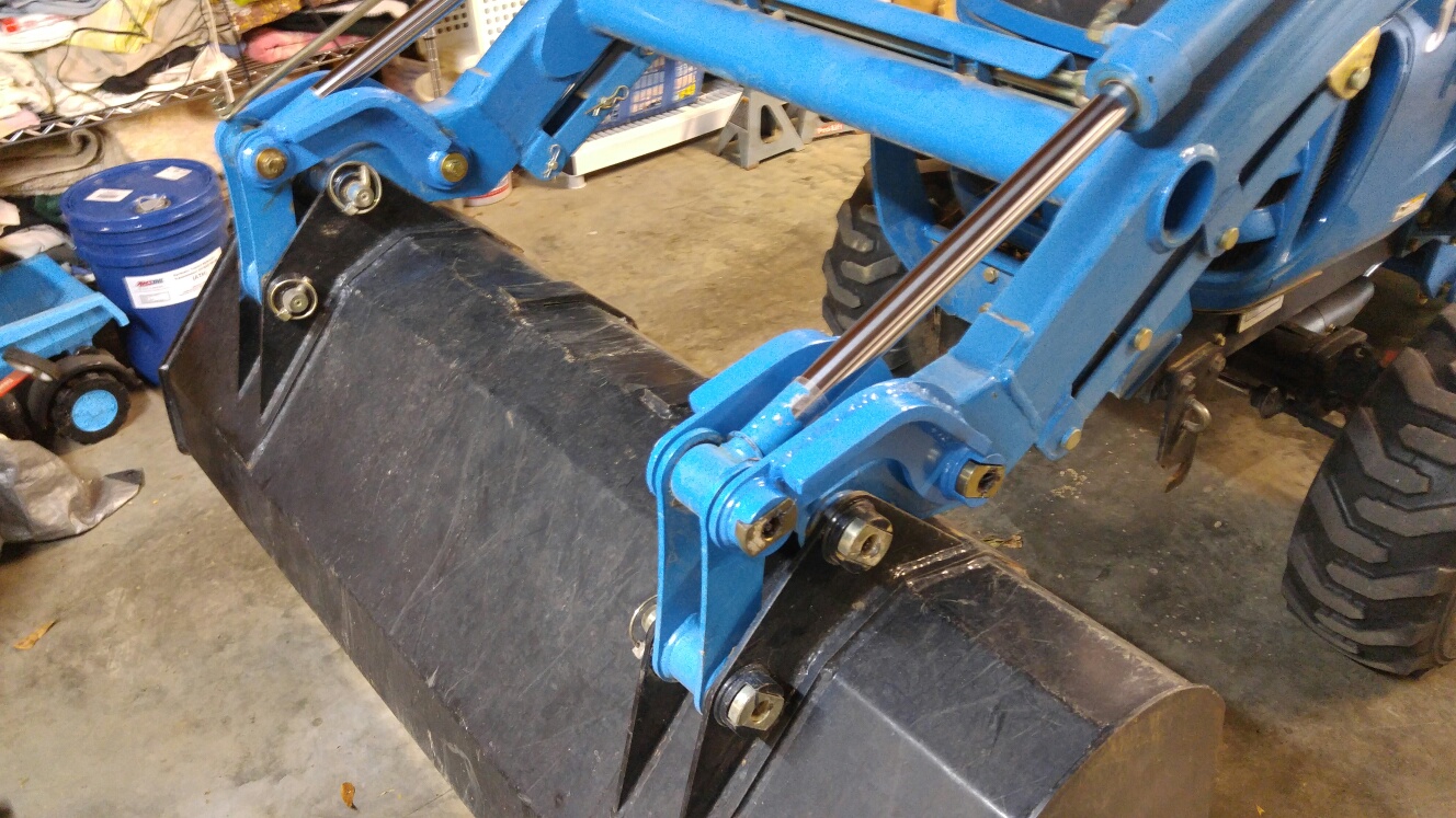

Rust-Oleum Professional Safety Blue 7524. I got it at Lowe's.
To my eyes it looks like an exact match. Attached is a pic of my reinforced FEL doglegs that were painted with the paint. 1024151505_resized.jpg 1108151617_resized.jpg

It does look like a closer match than Rustoleum Sail Blue I have used.
Good job on the doglegs. I've seen a few others that have bent them also, mine haven't bent yet but if they do that's how they'll get fixed.

Looks close enough for tractor work. :) Besides, it's not going to be in a car show. ;)
That looks real close to the old Ford tractor blue also. So far, the Ford/New Holland factory rattle cans have held up well with no fade in three years. Keep us posted on the Rust-Oleum.

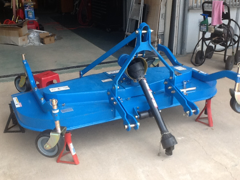

I had Sherwin Williams color scan my XR4046HC grill guard when I removed it to make modifications to it. The SW match is perfect as far as I am concerned.
My brand new LS 84" Rear Finish Mower got scarred up from shipping so had to repaint quite a bit of it. Hard to tell LS Factory paint from mu SW Match.

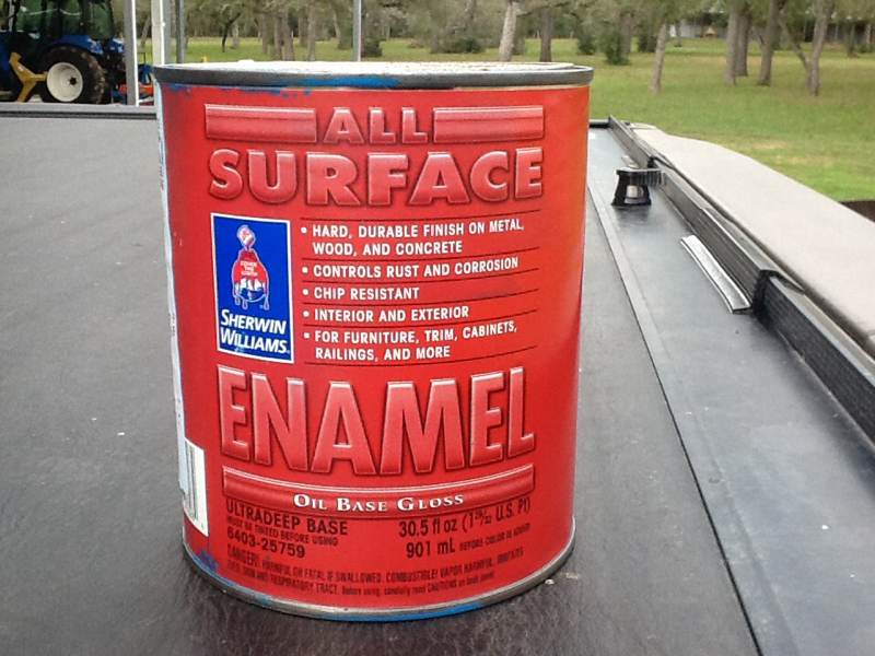

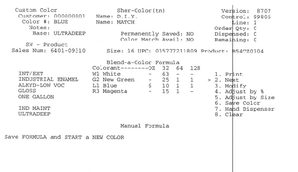

Sorry for delay. Here is the Sherwin Williams recipe for what I think is dead on match for LS Blue.

George;
I showed that to the guy at my Sherwin Williams store after we came up with my recipe and he said this one would be way different than the new one we made.
