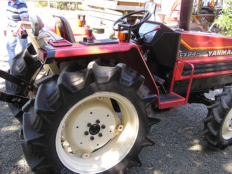

Hello to all...this will be a bit of a long post, but I need some advice about the next tractor I am going to buy this weekend.
I have a 2210D (2cyl 25hp and 2070 lbs.), and it does a great job on everything I need EXCEPT for grading my steep gravel drive. Whenever the 5ft boxblade gets loaded with gravel, it won't pull it up the hill - it just sits there and digs in. Dunno if this is a HP issue or a simple wieght of tractor issue, but I've decided to trade in the 2210D for another, heavier model with beefier tires and a little more HP.
I am looking at a 2420D (3cyl 28hp 2700 lbs) or an FX24D (3cyl 28hp 2690 lbs.) Hours are equivalent, age is equivalent, both tractors on the lot of a local Yanmar dealer who does their own refurbishing (they don't care about paint, give great support), and price is equivalent.
Besides grading the driveway, I will use it for plowing and tilling the garden, digging post-holes, and carrying 4x4 round bales on the 3 point. Eventually will put on a FEL and do dirt/compost/manure/gravel/mulch moving.
I know what the dealer says, but I want some second opinions...which would you choose, and why?

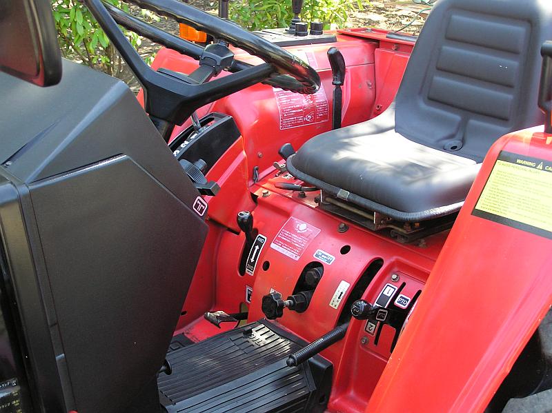

I've had a FX24D for 10 years until it dropped a valve and tore up the engine. It is a fine tractor with a flat floor for the operator area, but it is still tight. I would look at both those tractors with operator comfort/space in mind.

Thanks, that's good advice, as I am a big guy...I fit in the 2210, but it is TIGHT...so which would have more room, the fx24d or the 2420?

From a parts & dependability standpoint I'd go 2420 all the way. The F series are sure nice but parts availability is not great & they are not quite as durable.
The FX24 will be much easier to get on & off of.

Ponder, my FX24D had one of the hydraulic cylinder replacement seats, so it set a little higher and slightly more forward than its replacement. My 265LB buddy drove it all the time, and it was tight. The thing to watch for is clearance to the steering wheel.
Recommendation: go sit on each. Pick the one that best fits you today and consider any future planned changes (e.g. my seat.)

you will have more room in the 2420 than the fx24. I also think once you get used to the colum shift on the 2420 you will like it....I have had both models and I would go with the 2420 all the way.

If your current tractor can spin its wheels trying to pull the load, you have enough power. Your problem is a traction issue.
I question the spec'd weight given. The manual I have gives a lower number for weight that what you've sighted. BUT, I have an FEL on mine and I've had my machine on the scales. With just me in the seat, my tractor tips the scale just a couple pounds under 4k#.
I wish the F24 weren't so compact, longer wheelbase and more room in the drivers seat. It is a little tight getting on/off due to limited space between the steering wheel and the fender. I'm always hitting the turn-signal lever.
I agree with others saying you need to see for yourself if available room is better on one model than the other. But, there is more to consider than just seating room. There are a lot of options on the F series and one needs to give consideration as to which ones are on the unit you are looking at and how valuable they would be for your used. Mine as a 4-speed PTO and I find myself using more than one speed depending upon the task at hand. I also like the separate "creep" range as it affectively gives me 18 fwd speeds. The power shift comes in handy quite often for me. Does the units you are looking at have the UFO controls? I have mine connected and the auto depth (draft) and tilt control over my tiller to be a great feature. Have the auto tilt connected to my quick hitch and any implement use can be leveled with a twist of a switch. One option I don't have but could make use of is the quick steering. It's for light duty work but oh, so useful. It disconnects the rear wheels and tractor becomes a front wheel drive. Reduces turning dia at least by a third.

Just wanted to thank everyone again who responded. I ended up getting the fx24d. They delivered it yesterday, and I IMMEDIATELY stuck the box blade on and began to grade the driveway...NO PROBLEMS, it went up like "buttah" :).
I got the rear tires filled with flid (fluid, even...)to add 400 lbs, and then put 150 lbs of weights on the front end...also got a rock rake to go with it...I am rapidly expanding my implement collection! :) And since I use them all, my wife doesn't roll her eyes for more than a few minutes whenever I bring home a new one LOL
My only concern is that it is a little tight (as everyone told me)and I have bad knees...when I first got on yesterday, I couldn't get my heel back far enough to engage the diff. lever (my shifter, UFO are both on the right) because the shifter handle was in the way...so I just removed the T- shaped handle, and everything is fine...
