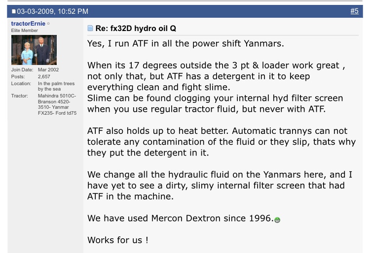

Its been a good tractor, (if a more than a bit unstable), but just blew an hydraulic line and I need advice on the oil to use. We can get absolutely no info from anyone in Aus on what oils the Yanmar use for the Auto/hydraulics, (which I assume are a combined system).
I saw some comment on the site about Dexron ATF, but was not sure they were talking about the FX235. Can any one give me more advice please.

I have no knowledge related to an of the FX models. But a quick internet search produced this find.
While I understand TractorErnie has gotten out of the tractor business, he has bern and continues to be a wealth of information about Yanmar tractors. Personally, I will take any information he provides to be among the best you will find anywhere on Yanmar tractors!
Hope this helps and best of luck on getting it back running.
Oh fyi, that is a screen shot of a TBN thread.
