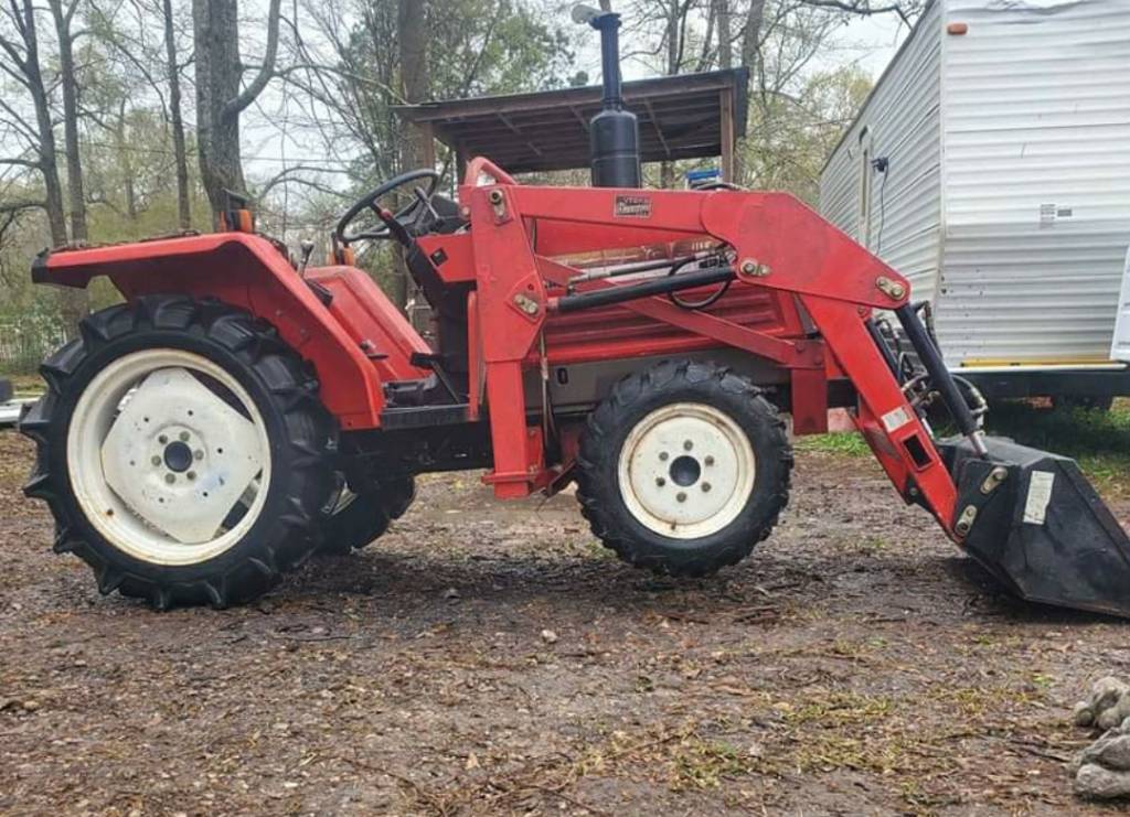

Anyone have any information on these tractors. Just found one locally for sale and cant finger alot of info on them. Says it's a 94, has loader, box blade, phd, and brush hog.
   / Fx20d info
Any known issues with them, parts availability, is it a good tractor lol
   / Fx20d info
This is it, alos comes with backhoe attachment Screenshot_20200306-082648_Facebook.jpg
   / Fx20d info #5
I do know of more than one having rear differential problems. I changed the ring gear on an Fx24D. It is only my opinion but if used with common sense shifting the power shift and making sure you use an over run clutch with a mower then I think the chances of trouble there are minimum. You can browse here and see pretty good parts availability. I would advise using caution with a 3 point backhoe.
   / Fx20d info #6
I have an F22D. Purchased it sometime around 2001 maybe? Purchased with 900 hours or so and the clutch/TOB was on its way out. I was able to coax another 400+ hours out of the clutch and finally had the clutch/pp/TOB replaced this past winter. I store it up camp and don't even place 40 hours/year on it. Other than an occasional battery & oil changes it has been nearly trouble free. I only have a manual shift but the "x" designates a powershift. It is a light weight unit.
If you have moderate slopes, do everything you can to increase your track/wheel width and lower your center of gravity. Load the tires, add weights to the wheels, add wheel spacers. I would also encourage you to add an aftermarket ROPS. HOYE tractor, Southern Farm Equipment Imports and others have good parts support.
