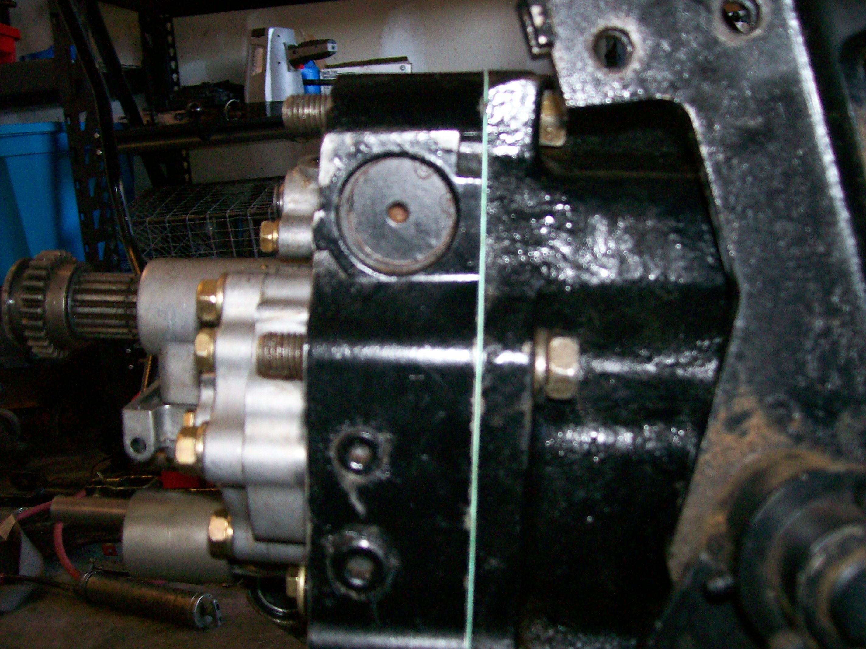

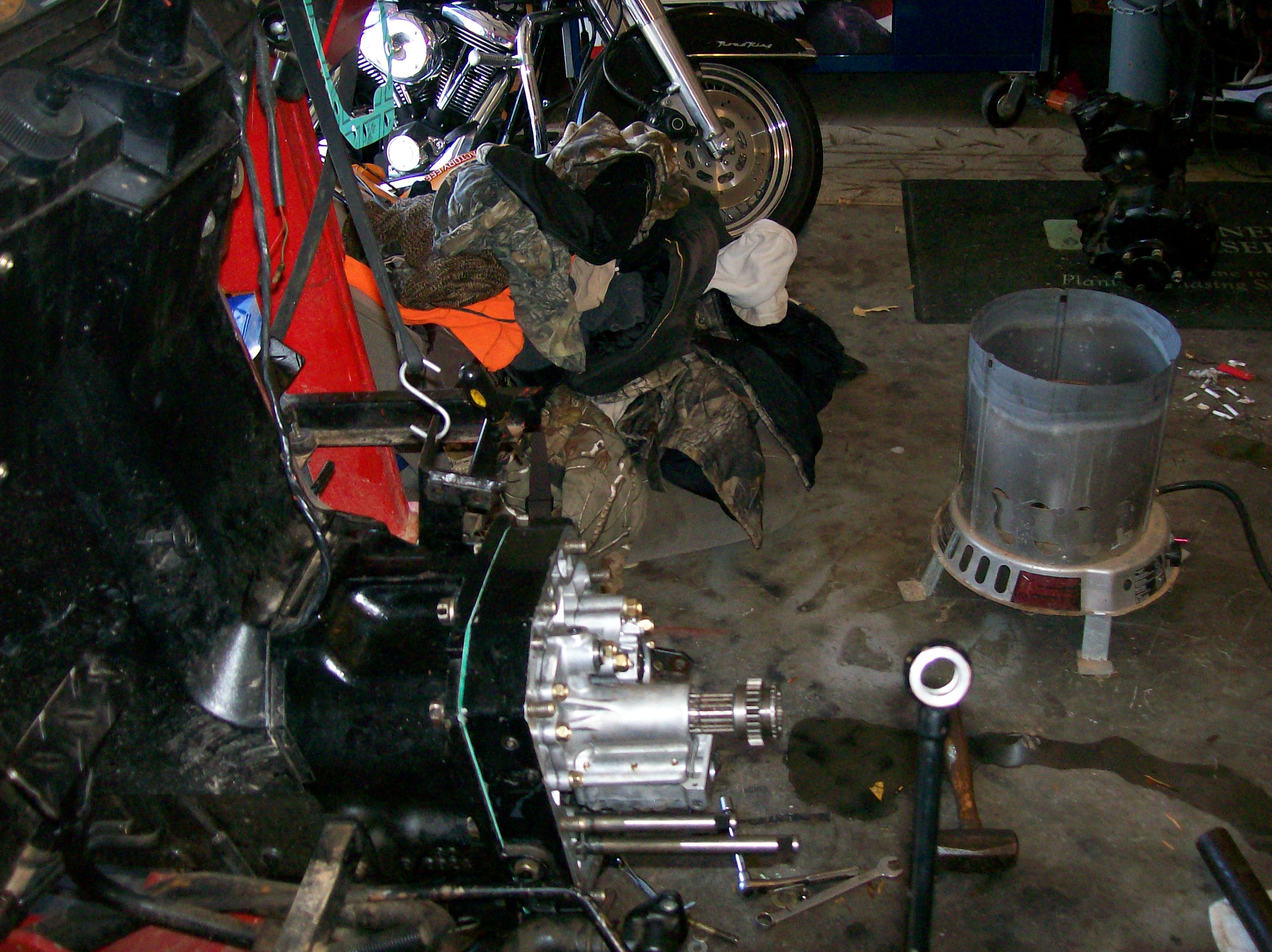

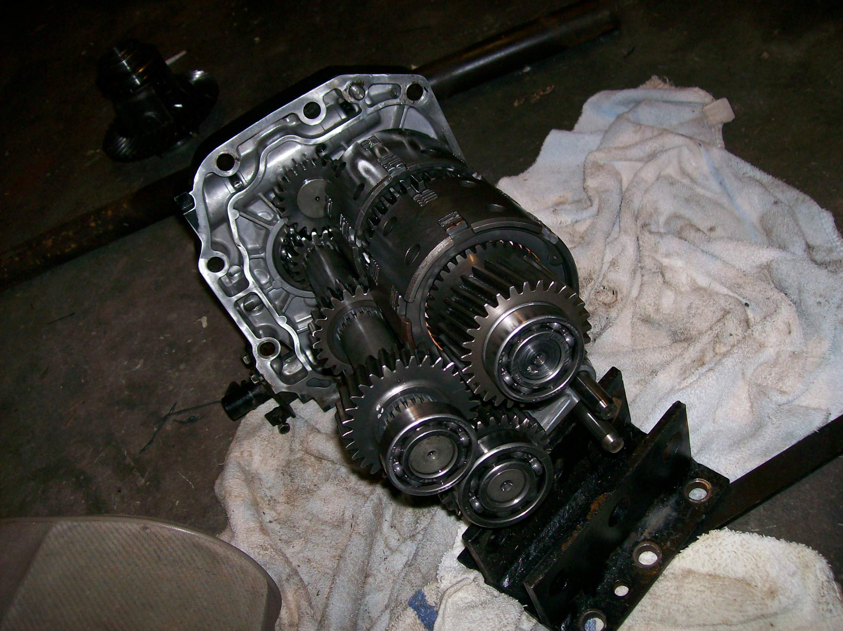

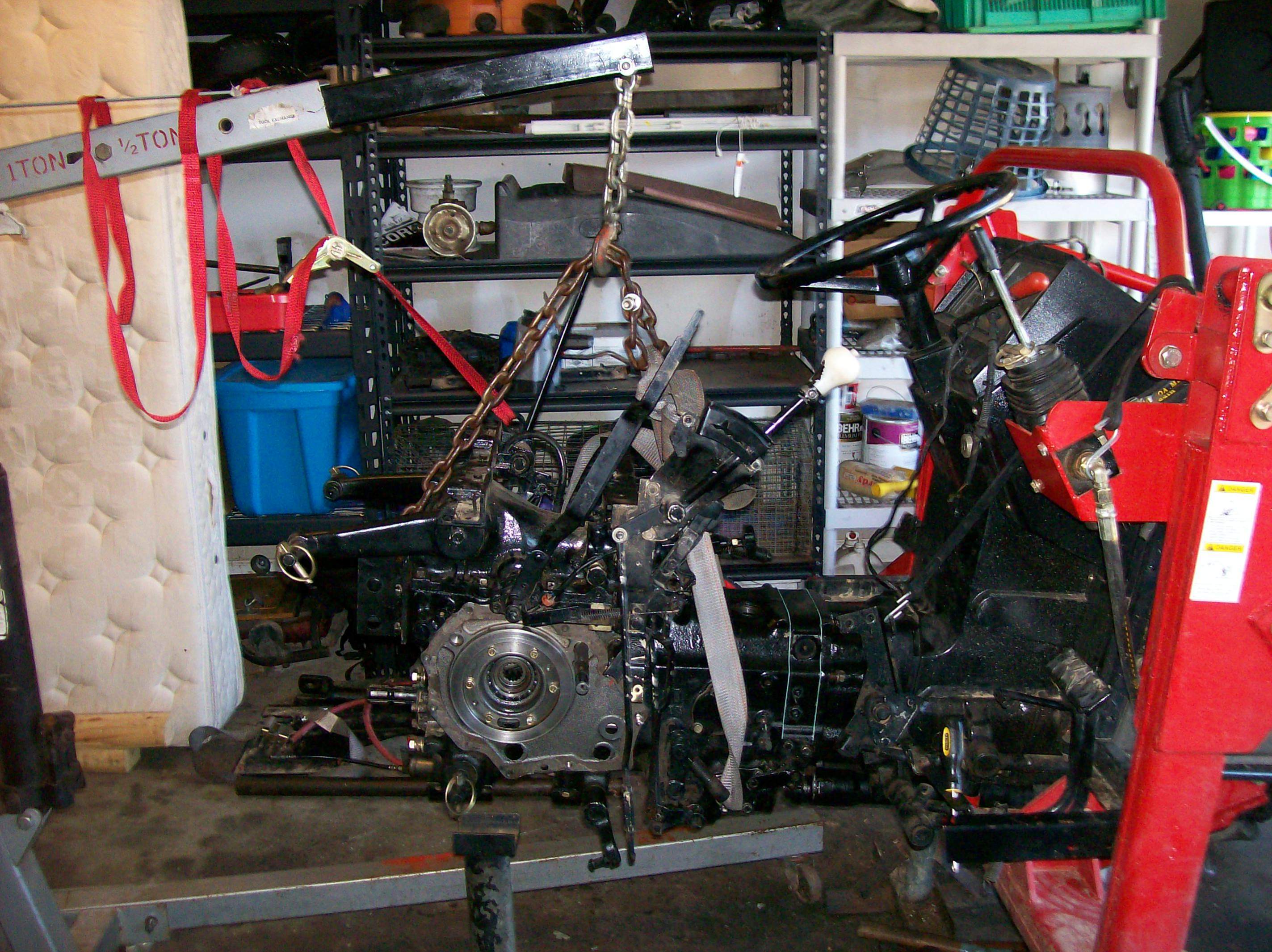

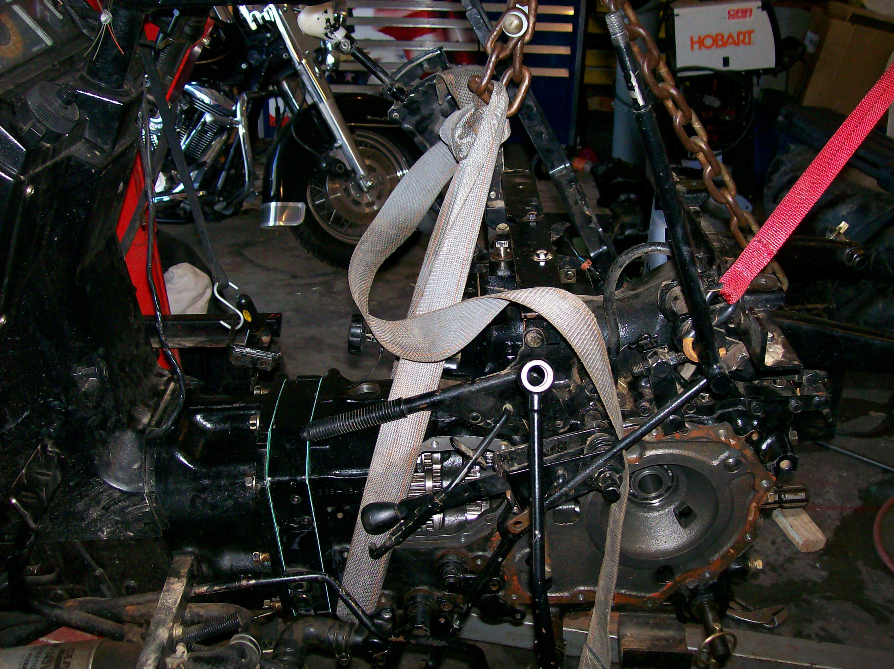

it worked by placing the powershift portion on the front half of tractor first then bring the back half up to it and line it up.

Glad you got it. :thumbsup: Was the misalignment the reason it wouldn't go together from your first thread on this subject?
   / fx 235 powershift trans
yea, hopefully i never have to do this agian but if i do i will definatly invest in a engine leveling device for my motor hoist, i think it would have made a world of difference doing this project solo.
   / fx 235 powershift trans #4
why did you have it apart clutch,power shift clutches ?? Glad you got it :thumbsup:
it leaked right there at that block(powershift portion) on both sides, and the ring gear had missing teeth so it all come apart to fix and put new gaskets.
   / fx 235 powershift trans #6
So there wasn't any problem with the end powershift clutch pack like we thought? Glad you figured it out! :thumbsup:
