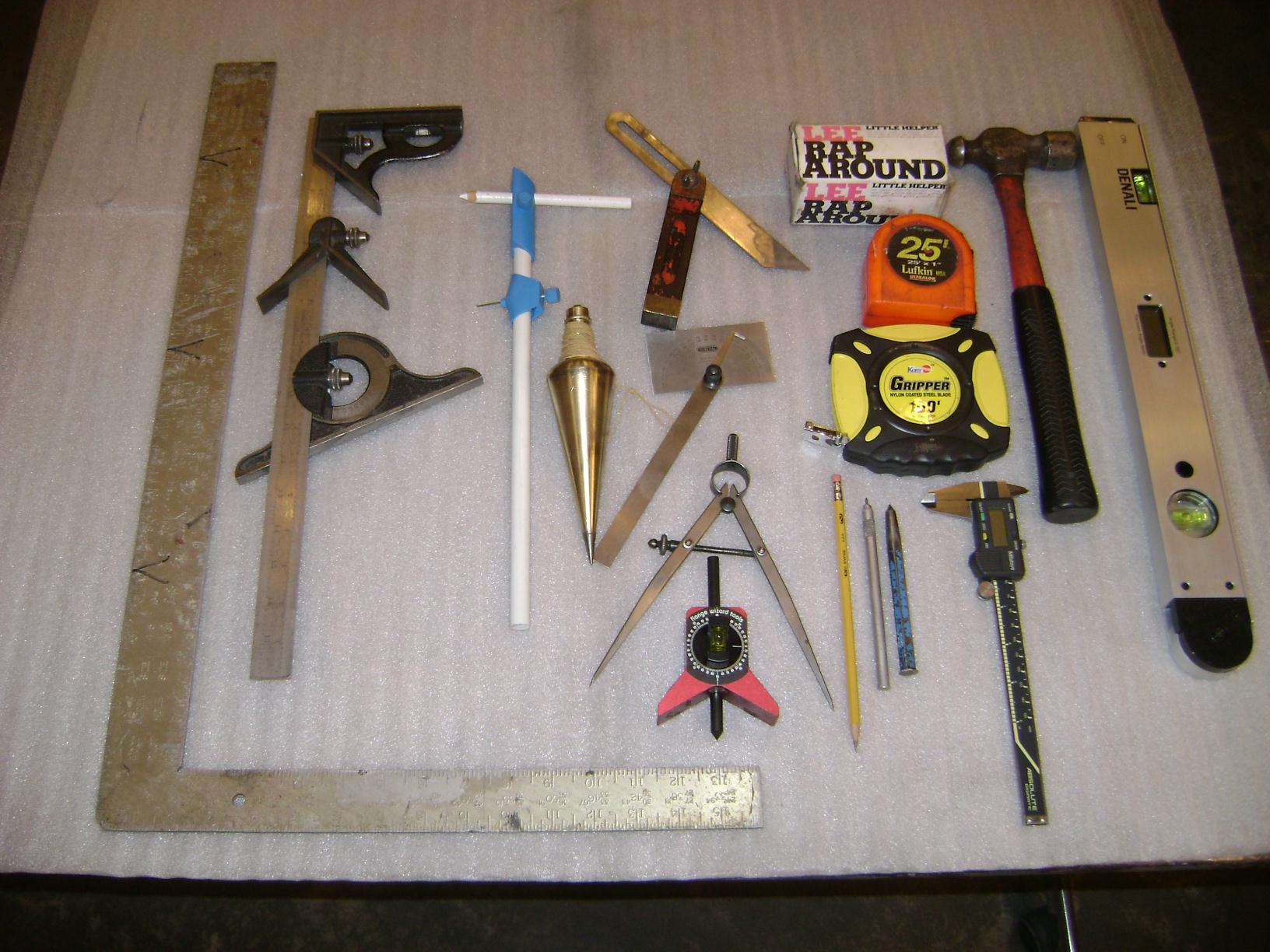

Personally I don't think you can drive home enough to young people the importance of blue print reading, layout, and reading basic welding symbols! Another thing that I see that is not being addressed any more is, preventing, controlling, and correcting warpage. Here is a very good book for a any person who wants to work in the trade. And a couple pictures of basic tools any weldor / fabricator should carry.
