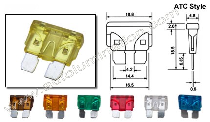

The Bussman fuses that I purchased are a little too wide to plug in, should I file them down a little to get them in?

You didn't say which type Bussman. If I'm not mistaken, ATC stye fuses should be a direct replacement.
That said, quite a few folks have actually pulled out the OE fuse box in favor of an aftermarket replacement.

ATV style is too small. The closest was MAX. I may have to replace the fuse box but I think I will try filing a little off the outside edge of both prongs and see what happens. Pat

Greg said "ATC". They are a perfect fit.

My bad, I meant to type ATC. The width of ATC prongs from one side to the other is 7/16th. The width between the prong holders on my 2002 is 6/16th. These are the really old fuses that came on the 2002 Jinma. I'll let you know if filing off a little on each prong works. Pat

Yeah, ATC is the wrong size fuse for that tractor. If you look at that diagram I provided above, you'll see the blade width of an ATC is 14.2mm. That converts to 0.55 inch. Your stated "6/16th" is only 0.375" inch. Folks with that size fuse had two choices; replace the fuse box and fuses with aftermarket ATC, or buy fuse wire. My Jinmas and my TaiShan used ATCs, but my KAMA used fuse wire, and I don't own any of them anymore. So I have plenty of extra fuse wire if you'd prefer to simply re-wrap your fuses.
