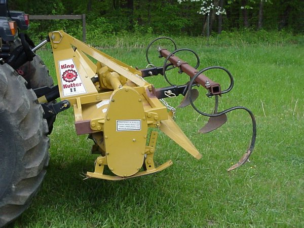

What would be the best 3 point implement for making planting rows or furrows. This is my first attempt at planting a large garden roughly 100 X 100 with corn etc and I am not sure what to use behind the ck30. I found the implement kit pictured at Stevens tractor, but I have no idea what's what or will make the planting beds in the tilled dirt. Thanks in advance for your help.

I saw one of those at my New Holland dealer. I like the looks of it! After the soil is tilled, you put the middle buster plow in the center and run furrows. Add fertilizer, mount the two disc at a 45 degree angle {more or less} just far enough apart to straddle the furrow. When you pull it forward, the disc will ridge up the dirt over the furrow. For keeping the garden clean, mount the small cultivator plows, leaving a gap in the middle for the rows and plow away. Did you see a price for it?
