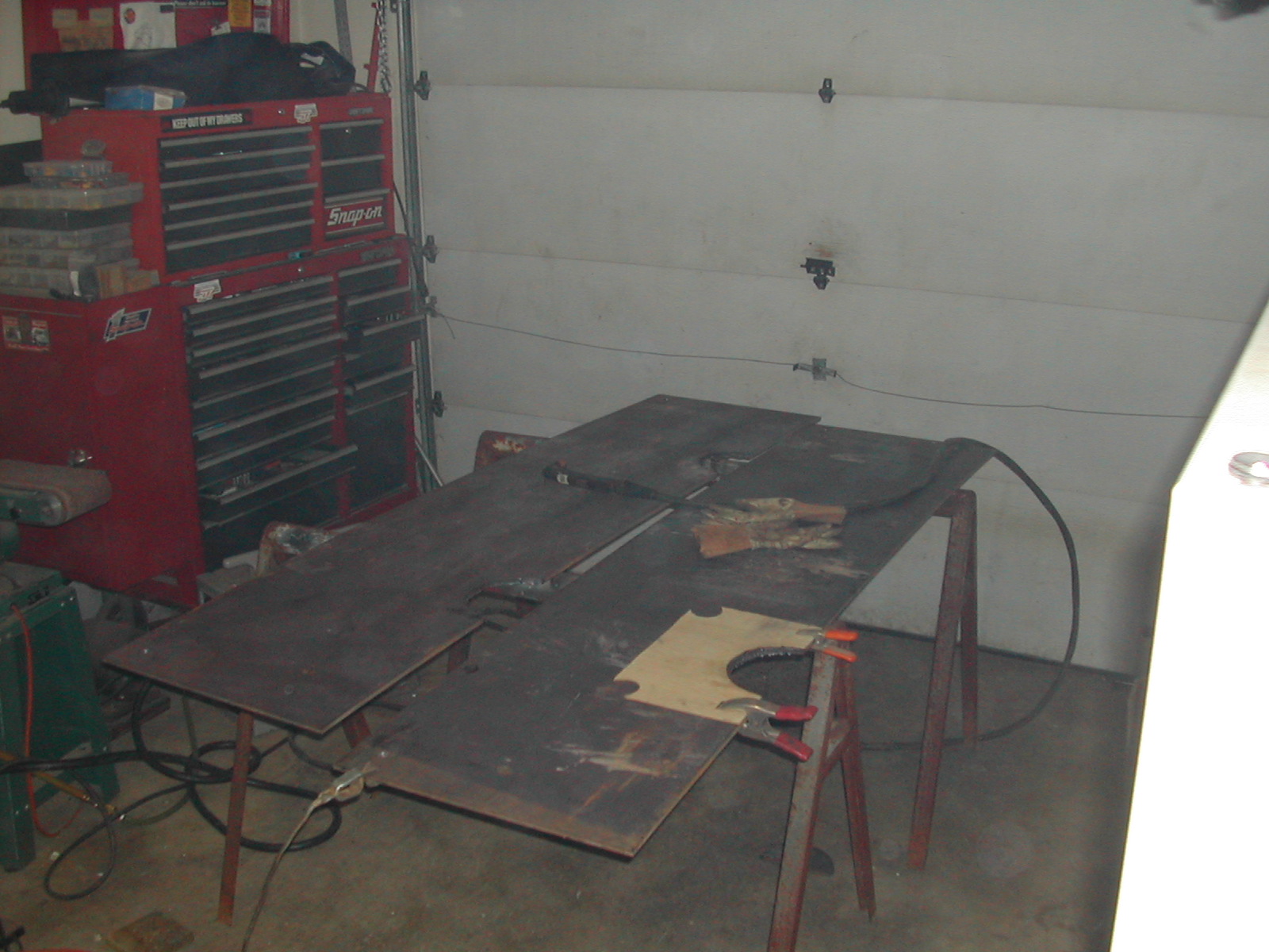

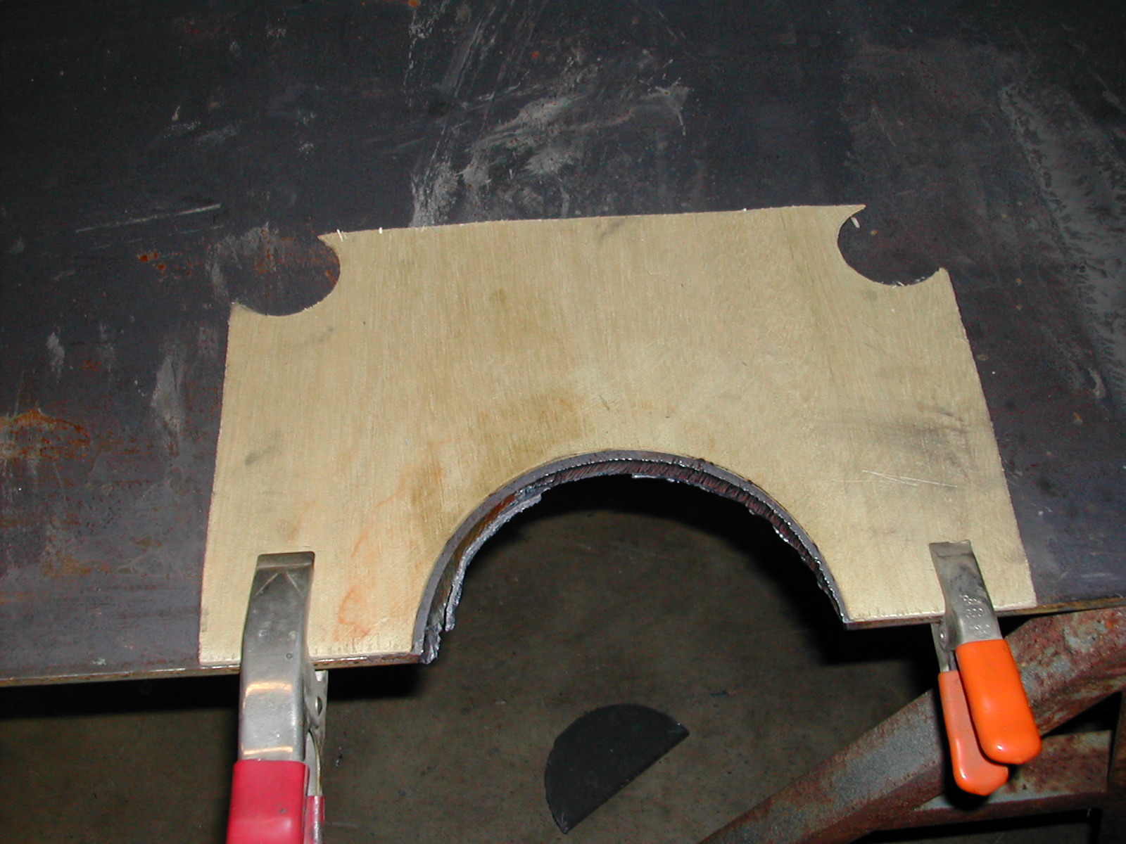

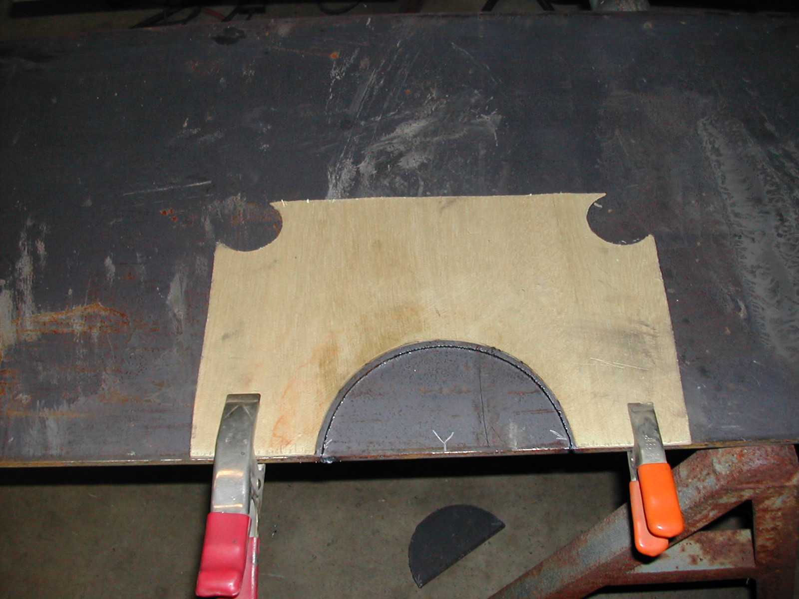

Doing a side project for a company I work with on occasion. 77" X 19" X 3/8" plate steel. two 1/2" holes to bolt to the floor, two 3.5" radius circles cut out the other side.
Man, the plasma is nice for doing things like this. Template is 1/4" scrap plywood. Pakmaster 50 with the high performance drag tip.
Lots of 4 1/2" grinder work dressing the sheared edges.
4 done tonight, 2 more to do, then I have to paint them... I hate painting.
They have a little bow from the shearing, not sure if I will try and take that out or not, probably call the customer and ask what they think tomorrow.

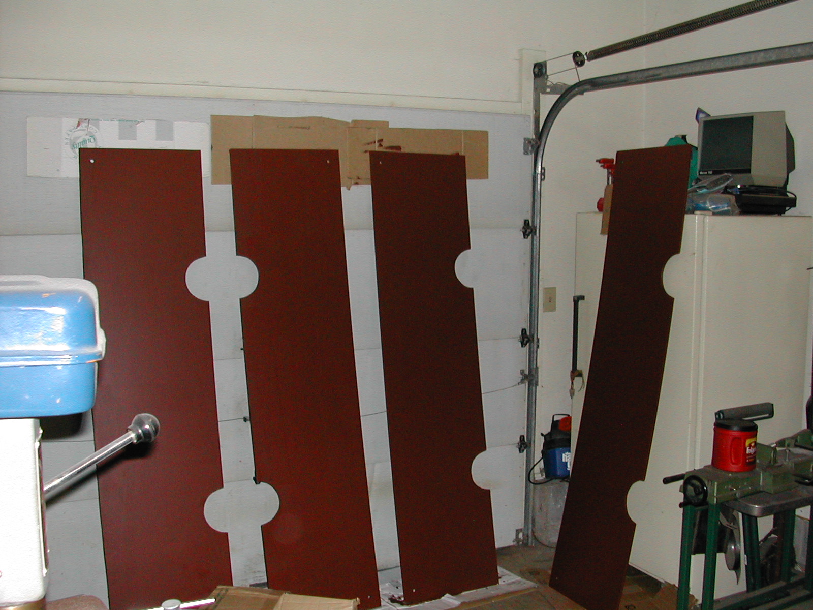

As usual, things go slower then I would like, but here we are in the painting stages, and it is just taking forever to dry in my cold shop.
Called my paint guy (I love saying that,,,, I got people, ya, right :) ) anyway, called my paint guy and told him what I was doing and a box with all the parts showed up. Quart of primer, quart of paint, cool little baby roller, little baby roller screen etc.
It was actually pretty bearable with all the right tools and materials right at hand. Cost me about $30 which kills me in some ways, BUT, it sure was nice to just have it all, and have the right stuff, not sitting there saying, well, a 4" is what I need but this 12" will work etc.
VERY little waste, Toss about $5 worth of supplies (roller covers, bucket etc) in the trash when I am done.... Not quite "green" cleanup but works for me, and get this project out of my shop! Although I believe there is a bunch of painting in my immediate future...........
