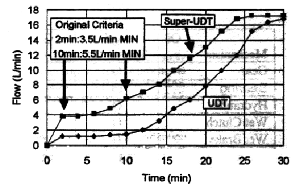

</font><font color="blueclass=small">( Even with SUDT, Kubota asks for something like 20 minutes at 10 degrees. The reason is they want the time to bring the hydro fluid up to temp too before it gets worked too hard. Engine heat spills to the hydro fluid, so they claim. )</font>
Jim, how right you are! /forums/images/graemlins/grin.gif See Kubota Super Universal Dynamic Tractor vs. UDT Flow Rate Graph above.
No wonder Kubota put their SUDT in our L-39 TLBs with 23 gallons per minute of hydraulic flow. That is almost 90 LITERS per minute! /forums/images/graemlins/blush.gif

The ONLY time the kinematic viscosity of SUDT is equal to that of UDT is @ 100*C or 212*F!!! /forums/images/graemlins/blush.gif
The rest of the time, SUDT doesn't even come close to that of UDT. /forums/images/graemlins/cool.gif
And anyone operating their hydraulic fluids @ 100*C is in for some MAJOR trouble! /forums/images/graemlins/laugh.gif /forums/images/graemlins/laugh.gif /forums/images/graemlins/laugh.gif /forums/images/graemlins/frown.gif
