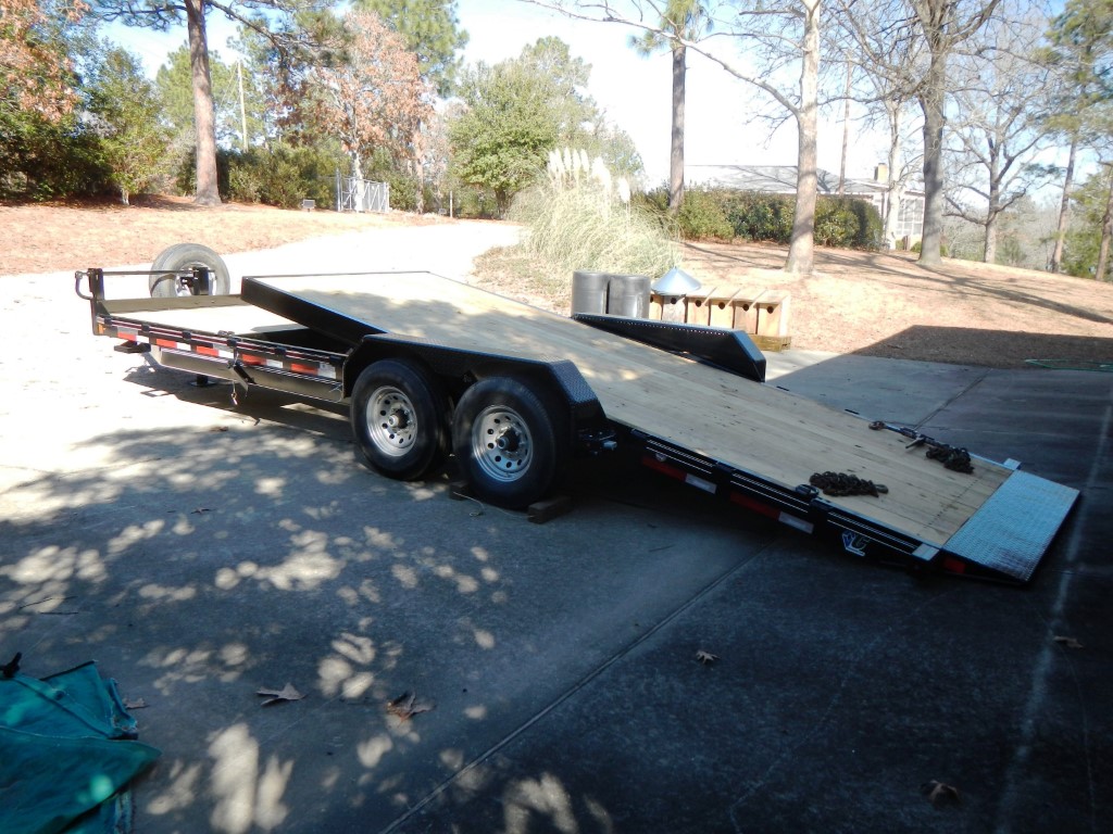

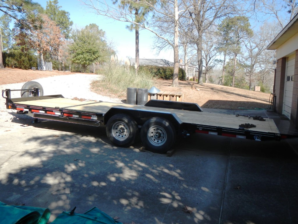

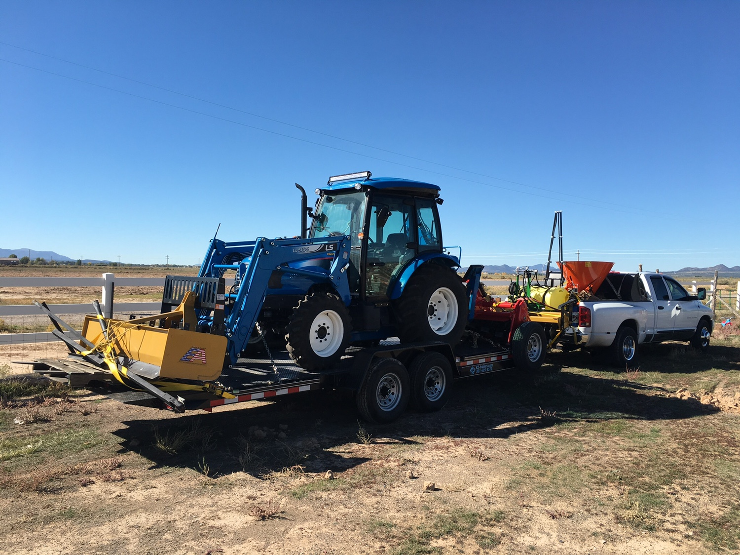

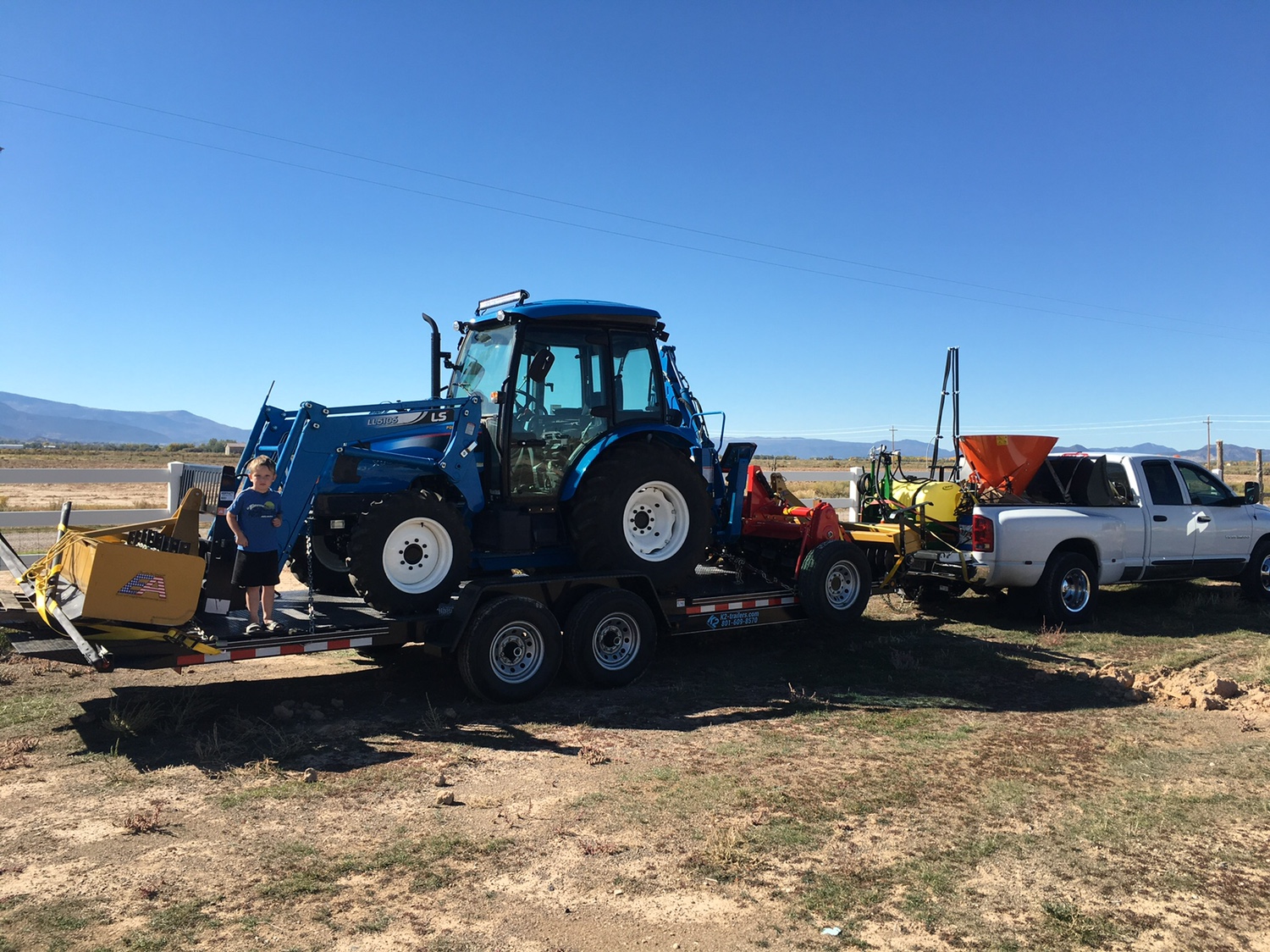

I have a 24’ gravity tilt deck. It’s an 8’ fixed and 16’ tilt. It’s tagged as 15k total. Steel deck and weighs about 4500 lbs.
I think it’s a Quality brand, make in OK, I think. It was very cost effective vs similar bigger name brand trailers. I’m very happy with it.
I probably have close to 12k on it in these pics.
