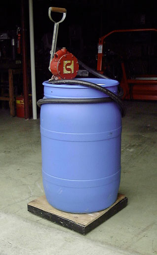

Jay, I just use a 35 gal. poly drum with a hand pump. (see attached photo) I can fit the drum in the back of the mini van and fill it up. I just slide it down the bumper to unload. I do use the Power Services additive and have never had a fuel problem. I fill it about 4 times a year, so the fuel is still fresh always.
