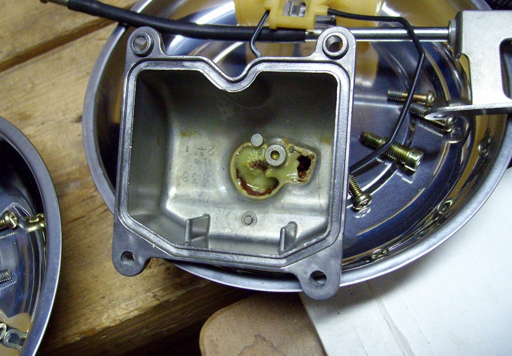

   / Fuel #5
I accidentally got a tiny amount of ethylene glycol coolant splashed into the fuel line on my motorcycle. So slight I didn't even know it had happened. It turned into a pasty, gummy glob in the bottom of the carburetor fuel bowls and clogged all the idle jets. Granted, this was gasoline and not diesel, but I wouldn't want even the slightest amount of ethylene glycol anywhere near any fuel of any kind!
- Jay
