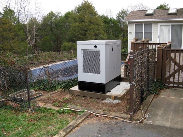

   / Fuel usage for Isuzu 12.5 kw generator
I looked on line at various diesels and their fuel consumptions. This is one reason why I bought the Isuzu, because its fuel usage was the lowest of almost any other.
It's also a gem in quietness. You really cannot tell it's a diesel. It has an enclosure, picture below.
Fuel usage on our old gas generator at 4 kw was 0.5 gph. It would run about 8 to 10 hours before needing refueled. The Isuzu has a 60 gallon belly tank. Should be good for 10 days.
