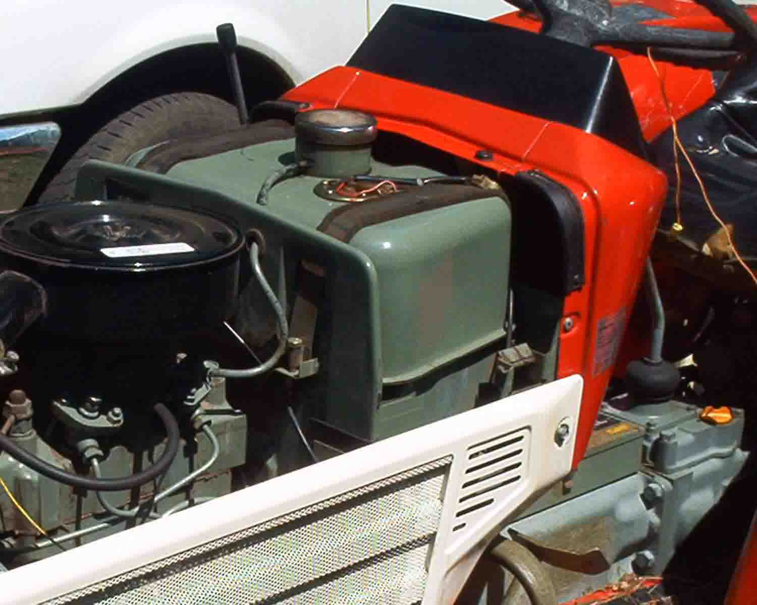

has anyone had a hole rubed thru on the bottom of the fuel tank? my ym2000 tank sits on the back bolt of the steering colum and has rubed a small hole thru the tank. so I'll be looking for a new tank and some sort of spacer to lift the tank up a 1/4 of and inch or so.
I'm kind of wondering if the tank just lost its shape or integrety in the heat hear in phoenix, or if there was supposed to be a spacer all along?

You might look for a 2000B tank, they are metal.

well I installed my new tank yesterday. perfect fit and it has been modified so it does not rub on the steering bolts anymor, YEA. also has anyone noticed the the search part of the forum does not work????
