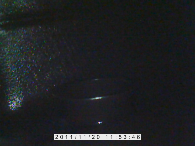

you might want to consider trying a suction-type oil changer--- the kind used for i/o boats.
Usually, the suction tube is small, to run down a dipstick tube, but you could replace it with a larger hose.
If you then place the suction hose directly on the bottom of the tank where the fuel flows out and create the suction, it should draw your debris up into the holding tank. You might need to try a couple of times.
Just a thought...
