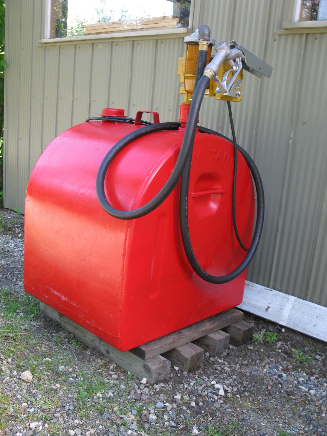

Of course that isn't such a problem for diesel. I was given a 150 gallon tank and stand but decided it would be too big for the diesel I use, and I am not sure if they will deliver such small amounts up where I live. It is a round tank so it would be difficult for me to handle for filling, and I'm not sure it would be legal to take to the bulk dealer. So, instead I bought a used 70 gallon (imperial) Tidy Tank for $150 which is a better size and shape. It is small enough for me to take it to the bulk dealer for refilling. I fill it three to four times per year. I'm not sure, but I think they also change additives for summer and winter, so that is another consideration.
I had to paint the tank and then added a $230 12v 13 gal/minute pump plus a water-absorbing filter for $40. Of course that's in Canada-everything costs more, and the way our dollar is going you guys would likely get the whole thing for $99.95. :)
