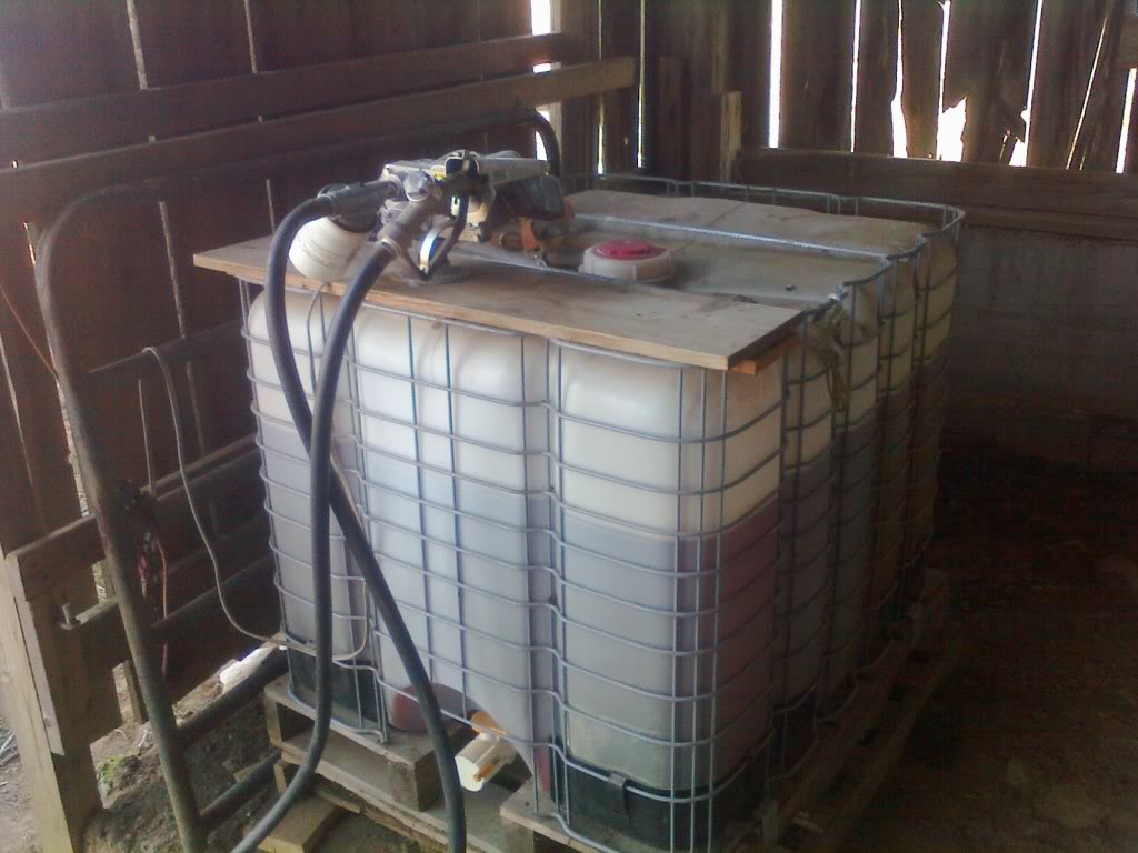

Last summer my brother in law picked up a plastic tote tank for me from a local chemical company. It was free for the hauling away. It hold 275 gallons, had a ball valve and cap on the bottom, a 8" screw on cap on top and surrounded by a steel tubing frame. It is made to be handled with a fork lift. My plans were to use it as bulk when the distributor said we had to have 250 gallon minimum order but he ended up not charging for the 175 gallon order we had so I haven't done anything other than set it beside my 100 gallon tank. I think I will end up doing kind of like Eddie did by connection them together with a hose and I can let it feed my smaller tank when needed. Since it is a lot higher than my 100 gallon tank, I would have to just keep the valve closed except when I needed to top up the smaller tank with the pump in it, at least till the 275 got down to about 1/2 full.
It is a cheap option if you pick them up direct or get them from Craiglist sellers who pick them up, clean them and sell for about $50 each.
You could also build a cribbing to set it on that is higher than your tractor tank and just hook up to the attached valve on the tank for gravity feed.
   / Fuel storage tank questions-Help needed #9
That's what I have. I added an electric pump and an inline filter. It works great.
I did have one supplier look at it and say something about they are not supposed to fill plastic tanks, but he went ahead and nothing more has been said.
I do keep it out of the sun, I'm not sure how long that plastic will last if it is constantly exposed to sunlight.
I still have the original water and particulate filter on it. It's been in use for 5 years now. I go through 3-500 gallons a year.
Some time when I need fuel for starting a brush fire or something, I will tap off of the bottom drain and see if there is any moisture in it.
