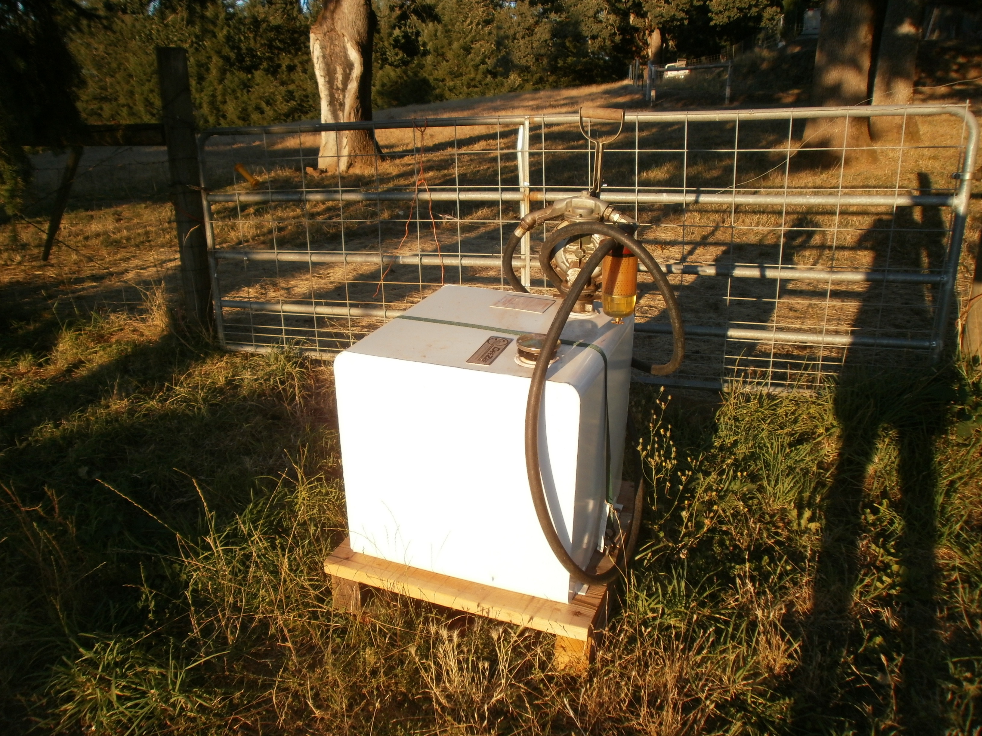

P8050013.jpgYour three hundred gallons fuel tank and fuel and are gonna be heaveee. Huge HD castors underneath a home made pallet made of wood or steel would keep the center of gravity low and provide a space underneath for forklift forks. Picture this with castors under it.

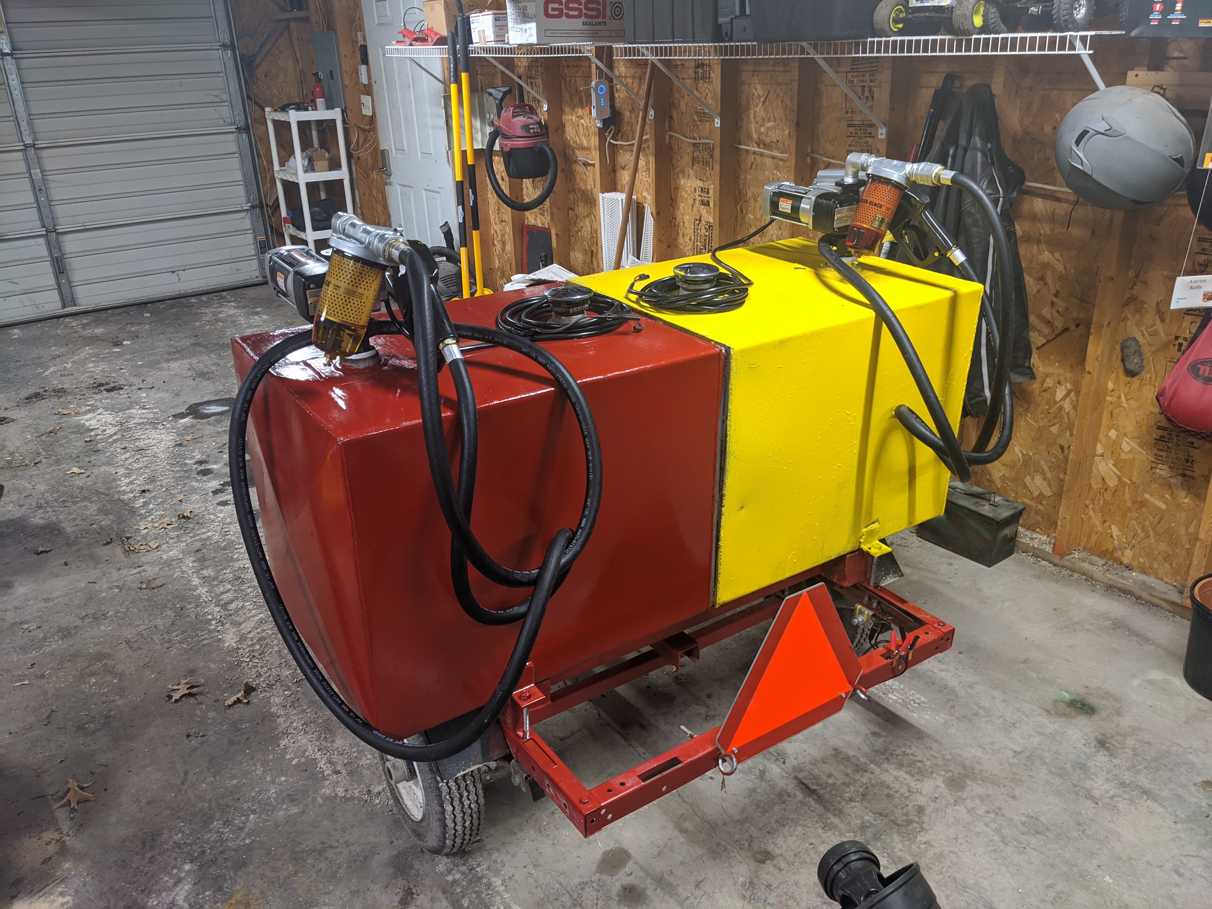

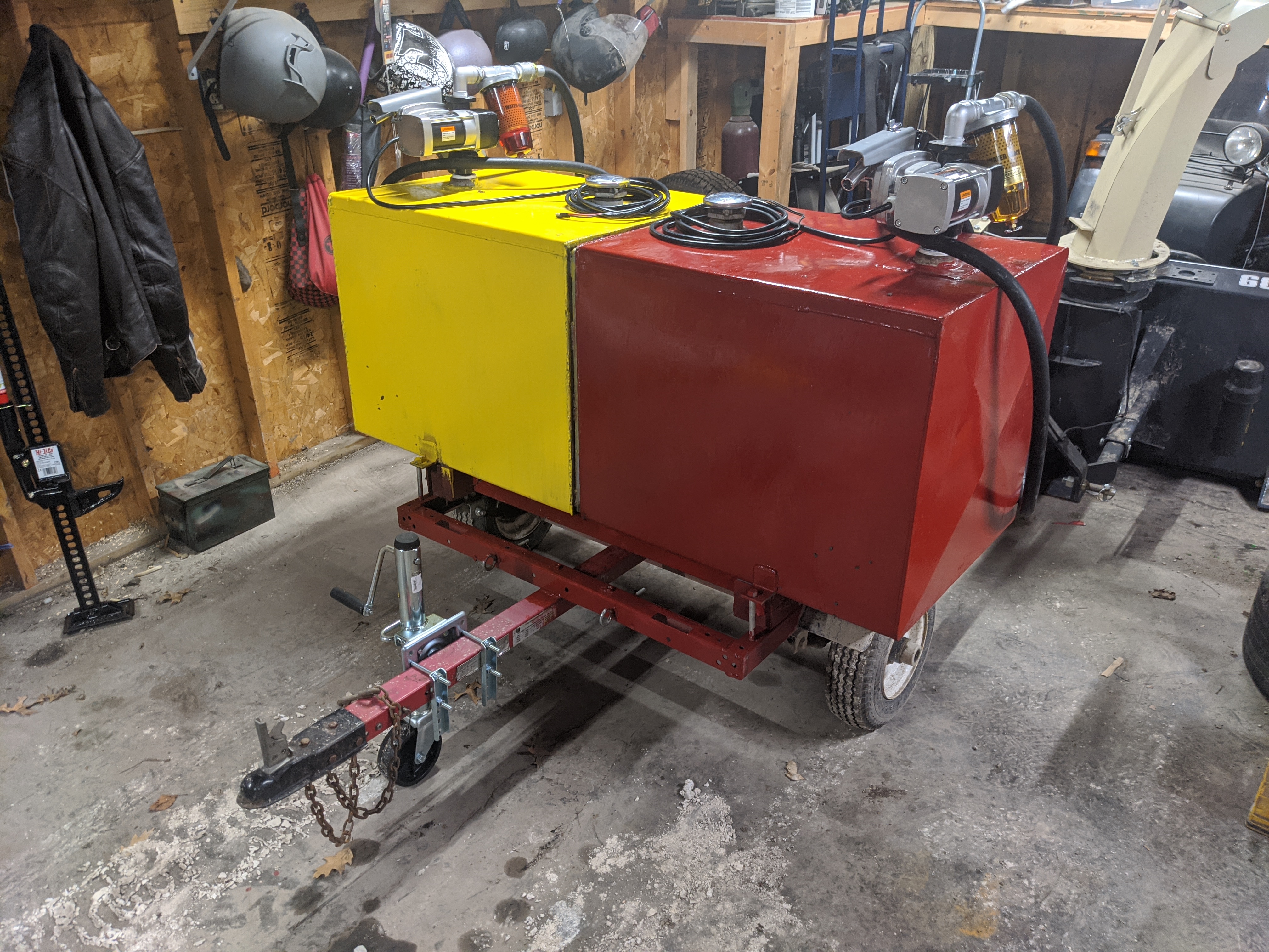

My initial idea was that I would have to build a frame or pallet to set the skid tank on. Ideally throw two sets of axles underneath it. Like a header cart for a combine. I want to be able to pull it out of the barn so the fuel truck doesn't have to drive all the way back to the barn to fill up the tank. Then pull it back with the tractor.
   / Fuel Skid "Dolly"? #10
My setup is WAY smaller in capacity and the trailer is far to weak to support what you want.....but more frame, stronger axles.....you could accomplish the same end result.
Its VERY handy. That tank is 150 gallons overall....tows easy with even a 12hp lawn mower.
