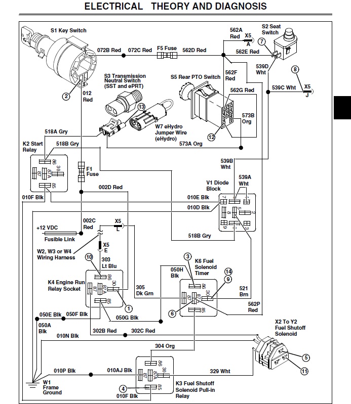

I thought my 4310 had ran out of fuel. It hadn't but I filled it up and it would crank, but was not getting any fuel. I found out my fuel shutoff solenoid wasn't working and bought a new one. It still doesn't work. I need to know which fuse or relay sends power to it. My fuses are good. I don't have a wiring diagram for it. Please help.

This is one circuit for the 4310 that involves the fuel shutoff solenoid and the ignition switch. Maybe it will help.
