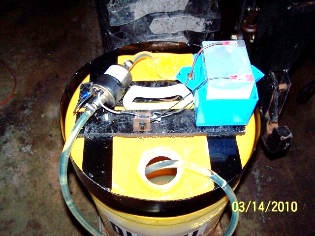

Built my own tractor refueling station this weekend. Its a 15 gallon plastic barrel with an automotive type electric fuel pump powered by a small trailer battery. I got tired of holding a 5 gallon jug almost 5' in the air to reach the tractor tank. And since my tractor tank holds 8 gallons I'd have to use two jugs to fill it.
Its much easier to turn on a switch and refill the tank in a minute or so than waiting for the safety type 5 gallon jug to put some fuel in then suck some air before the next few ounces went in. (I hate safety jugs that don't have a vent hole)
The black piece on top is made from some 1/16" metal I wrapped around the tank, clamped then removed and welded. Then I welded a couple cross pieces to support the pump and battery. The battery fits snugly in a plastic electrical box. The entire unit is removable if I want to take the tank to fill at the truck stop or I can use the pump to refill it from the 5 gallon jugs.

Mine is very similar in concept.
Added a suction tube to the pump inlet so that I simply stand it in the drum.
Also added an in line on/off switch and I take my 12 volts from an aux plug that goes directly to my battery.
That way I can transfer from a variety of containers.
